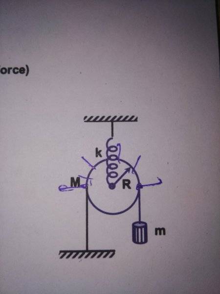

How to apply constraints in the system to get a relationship between the displacements of block of mass m and pulley of mass M.?
T.a= 0
Assuming tension in both strings to be T .
-T × a1 ( for the block) + 2T × a2 ( for the strings attached to sides of pulley) + for the string attached from the centre = 0
I can't understand how to proceed

The place to start on a pulley problem is this the kinematics, not the dynamics. If the center of the pulley moves downward a distance y, and the string is of constant length, how much does the mass move downward relative to the center of the pulley? Relative to the table?
If that were true, why would the pulley rotate?
Why should it rotate ? It's fixed to a table so the tension in both strings should be same
That's the issue .. I don't know how to establish a relation..
The pulley doesn't know what the string is attached to. This is not a massless pulley. If the pulley has accelerating rotation, some net torque must cause it. Where is that coming from?
Establishing the kinematic relation is a math problem. The length of the rope is constant. This is the constraint you need to use.
