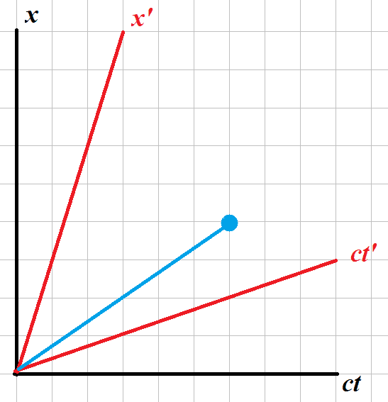

I'm doing some undergraduate research related to the Lorentz velocity transformation. I've done a basic derivation of the Lorentz transformation in the attached document. I got some feedback from my professor but I am not understanding what he is looking for. Comments from my professor are in the details below. Any insight would be appreciated as I do not see where or in what ways the transformation is invalid for ux < c.
1. The 2nd line on the 3rd page of your notes, you have x=ct and
x'=ct', thus ux=dx/dt and ux'= dx'/dt' =c according to Einstein's
assumptiuon.
2. But near the end of the last page, you wrote dx'/dt' = (ux
-v)/(1-vux/c2) . Compare with 1. This equation can be valid only for ux=c
and it is not valid when ux <c.
3. But in the book ux can be to be less than c, how come?
Seems to me that the professor is worried about your derived transformation is only valid for the case where ux = ux' = c, but that is how you define the transformation and thus come up with the approriate value of the constant a, namely 1/sqr(1-(v/c)^2) which guarantees that ux = c <=> ux' = c aswell.

"The Lorenz-Transformation is based on c2t2-x2 -y2 -z2 =c2t'2-x'2 -y'2 -z'2 (A) where (x,y,z,t) and (x',y',z',t') are coordinates of a light signal (photon) with speeds ux = ux' = c in systems O and O' respectively;
and O' is moving with speed v respect to O along +x direction. Can you show that (A) is also valid for a material particle which moves with speed ux and ux' < c?"
My response at this point is as follows:
The equation [A] above is the invariant spacetime interval and is a fundamental component of general relativity. If we simply replace c with velocities of matter ux and ux' then those would be isolated observations within each reference frame and not translations of relative velocities between inertial reference frames. That is the whole purpose of the lorentz transformation and the gamma factor.
Of course I may be missing something completely here so I would appreciate any input and perspective you can provide.
you did derive ux' as delta x'/delta t' and then you used the Lorentz transformations for delta x' and delta t' to get an expression for ux' in terms of c, v and ux
Let me drop the y and z now, its not important for your boost in the x-direction.
I guess you could use a space-time diagram and draw the worldline (blue line) for a particle traveling with constant speed. In S (black) it would be u = x/t and in S' (red) it would be u' = x'/t'
In S calculate (ct)^2 - x^2 = (ct)^2 - (ut)^2 = (c^2 - u^2)t^2
In S' calculate (ct')^2 - x'^2 = (c^2 - u'^2)t'^2
and show that you get the same value by using the formula for u' in terms of u and v.
Nice numbers to use are v = 0.6c which gives gamma = 1.25
Then use some values for u expressed in c (s.t. u < 1c)
