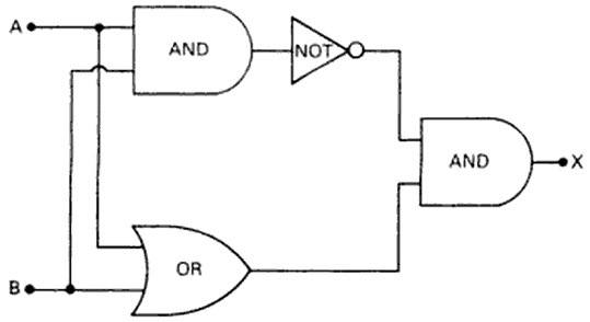

Construct a truth table for the combination of logic gates shown above.
2. The attempt at a solution
First of all the combination of logic gates with added letters to the combination:
The truth table:
I think it should be correct. But just want to be sure.
Looks right.
