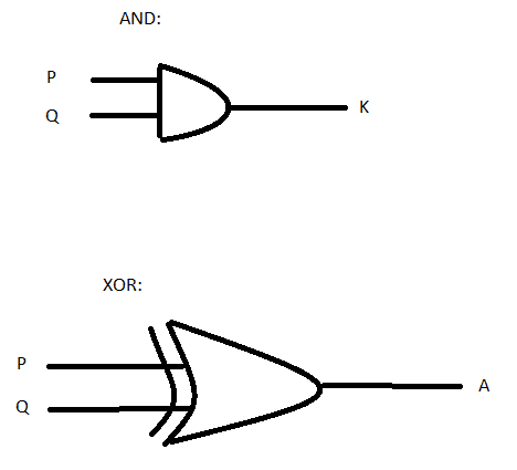

I want to construct a circuit that implements the following truth table:\begin{equation*}
\begin{array}{c|c|c|c|c}
P(Input) & Q(Input) & K(Output) & A(Output) \\
\hline
1 & 1 & 1 & 0 \\
1 & 0 & 0 & 1 \\
0 & 1 & 0 & 1 \\
0 & 0 & 0 & 0
\end{array}
\end{equation*}In addition, I want to use the above circuit to construct a full adder, i.e. a circuit that adds three 1-digit binary numbers.Could you help me to construct the wanted circuit that implements the truth table? :unsure:
Hey evinda!
Isn't output K the result of an AND port?
And output A the result of a XOR port?
Can we construct a circuit from those? 🤔

The XOR port gives $1$ when the input of true inputs is odd and $0$ otherwise, right? (Wasntme)
Can you help me construct the desired circuit? Do we create circles that represent the AND and XOR port and create arrows representing each possible input and ending at the output of the port? Or do we do something else? :unsure::unsure:
Yep. (Nod)
The are usually drawn as shown in the wiki article about Logic Gates. 🤔
So you mean we construct the circuits as follows?
If so, does this mean that the we distinguish the circuits, i.e. what they represent, by taking into consideration the form ? :unsure::unsure::unsure:
Yep. :)

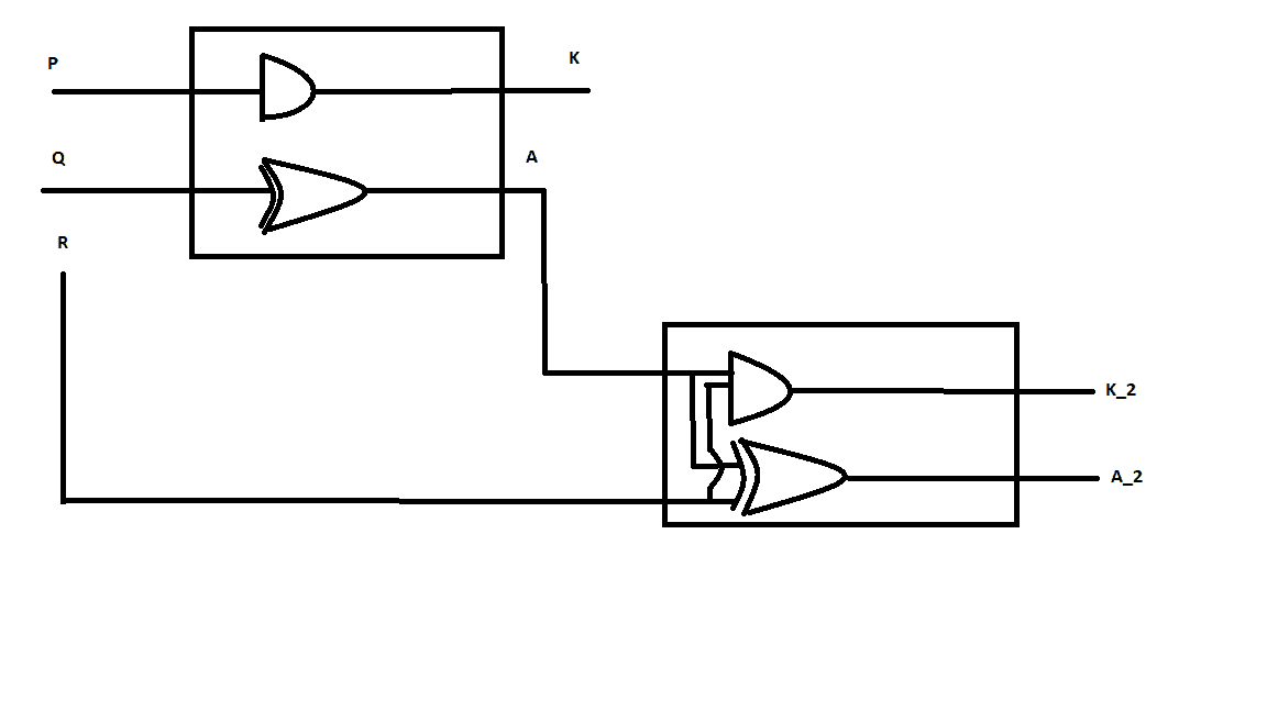

Yes, put the two logic gates into 1 box, which will have inputs P and Q, and outputs K and A.
Afterwards I guess we'll have to reuse that box multiple times to achieve adding 3 binary bits. 🤔

So we just draw a box including the both circuits above? Then the circuits would be independent one an other... Or do we connect them somehow? :unsure:
The surrounding box should have only 2 inputs.
Inside the box those inputs should be split and go to both of the logic gates. 🤔

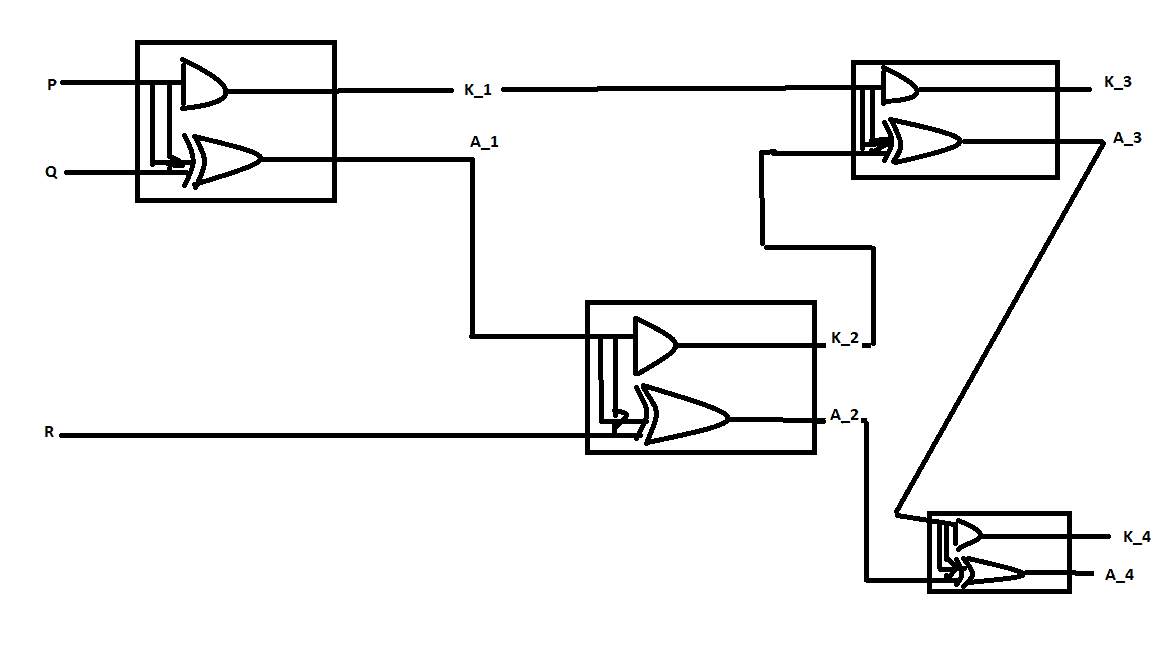

So we make the truth table for the sum of two inputs and then we find the truth value for the sum of the result that we find with a third input?
Or do we calculate directly the truth table of the sum of three inputs? :unsure:
We could do either, but your problem statement says:
So I believe we need to build a circuit from blocks that sum two inputs. 🤔
If we want to add two 1-digit binary numbers, we could give them as input at the circuit we created and the sum will be the value of K, won't it?
And then we could use the K above as the one input and the remaining 1-digit binary number and the new K that we will get will be the result of the sum of the three 1-digit binary numbers, right? :unsure:
But is this that what we want ? Because the exercise asks to construct a circuit that adds three 1-digit binary numbers... And the way I said it we implement twice a circuit, i.e. it is not a joined-up circuit and so there is no continuity... :unsure:o_O
Isn't A what we get if we add P and Q together?
Except if P and Q are both 1, in which case we get the 2-digit number 10 that is represented by K and A together? 🤔
K is then the so called carry.

So is it somehow as below? If so, what do we do with the carries? Why do we add them? And also, if we use the sum, don't they have to be connected somehow at the circuits? :unsure: :unsure:
  • #34
Shouldn't the block in the left top be the same as the one at the right bottom? (Worried)
I'll assume that it is, since otherwise it won't work.
Suppose we calculate $P+Q+R=1+1+0=10$.
Then we would get the outputs $K=1$, $K_2=0$, and $A_2=0$, wouldn't we?
How are those supposed to represent the result? o_O
Shouldn't we have just 2 outputs? 🤔
Oh yes, sorry! That's what I wanted to draw :oops:
Yes (Nod)
We do not get the result because the carries are not added, right?
Should we have in general only two outputs? So do we connect the arrows of the first circuit directly with the second circuit? Also do we have to connect in the second circuit the results $K_1$ and $K_2$ in order to get the right carry as output?
In general, the only possible results are $1+0+0=1$, $1+1+0=0$ with carry $1$ and $1+1+1=1$ with carry $1$ and we can get it with any possible order of $0,1$ at the sum, right? :unsure::unsure:

So is the desired circuit the following? :unsure: Then the sum P+Q+R is $A_4$.

  • #40
evinda said:
So is the desired circuit the following? Then the sum P+Q+R is $A_4$.
What about the carry?
Shouldn't we have $K_4$ as output then as well? 🤔
Suppose $+Q+R=0+1+1=10$. Then we get $A_4=1$ don't we? (Worried)
evinda said:
So at the first step the possible sums are 0+0, 0+1 and 1+0, 1+1 and then at the second step the possible sums are the results of these + 0 or 1, right?
Yep. (Nod)
  • #41
Oh yes, right... :unsure::unsure: So do we have to add an other circuit in order to include $K_4$? :oops:
  • #42
evinda said:
Oh yes, right... So do we have to add an other circuit in order to include $K_4$?
We already have $K_4$ don't we?
But I think the circuit is not correct yet.
If we have $P+Q+R=0+1+1$ we should get $10$ shouldn't we? That is, $K_4=1$ and $A_4=0$.
But don't we get $K_4=0$ and $A_4=1$? (Worried)
  • #43
Oh yes, you are right! (Wasntme) I have noticed that the second circuit gives the right result...
Does this happen for any possible case? So is $A_2$ with carry $K_2$the desired sum? :unsure::unsure:

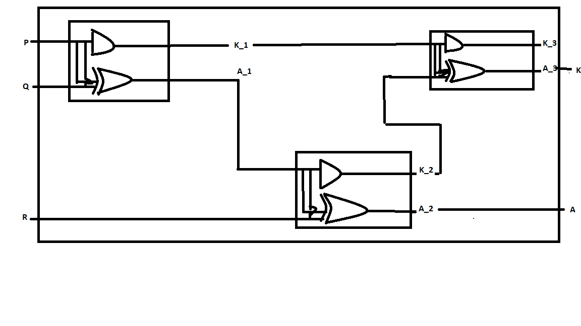

I have thought about it again... :unsure:
Is the desired circuit the following?
  • #45
Looks good to me! (Nod)
