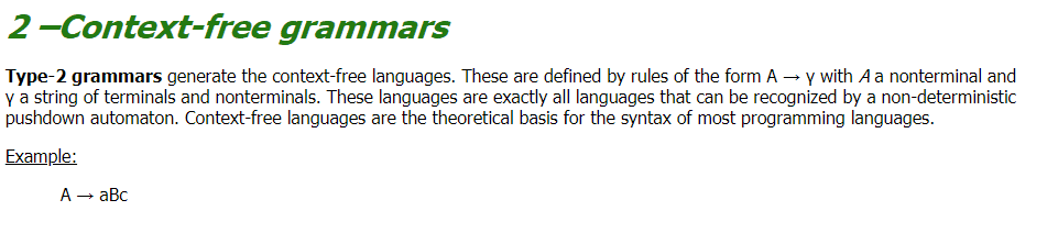

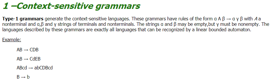

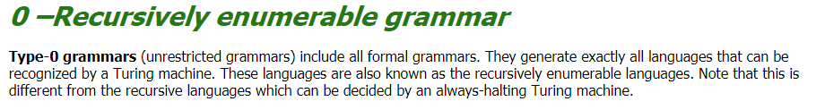

I have found the following about the possible types of a grammar:
From the above, I understand that if a grammar is of type-2, then it is also of type-1, right? (Thinking)
Also, all the types 1,2,3 are also type 0, right? :unsure:
As for the type-3 grammars, I haven't understood something... It says that on the left-hand side we have a single nonterimal and at the right-hand side a single terminal, possibly followed by a single nonterminal. Then why is A->abcB allowed, as it stated at the example? :unsure::unsure: Shouldn't we only have rules of the form A->aB? Could you explain it to me? :oops:
Maybe, but it does not seem to follow directly from the definition.
That is because I think $\gamma$ can be empty in the type-2 grammar, but must specifically be non-empty in the type-1 grammar.
That depends on how a 'string' is defined though - whether it is allowed to be empty or not. :unsure:
I believe so, yes.
We should be able to recursive apply each possible rule and backtrack, making each of the types 1, 2, and 3 recursively enumerable, and therefore a type 0-grammar. 🤔
evinda said:
As for the type-3 grammars, I haven't understood something... It says that on the left-hand side we have a single nonterimal and at the right-hand side a single terminal, possibly followed by a single nonterminal. Then why is A->abcB allowed, as it stated at the example? Shouldn't we only have rules of the form A->aB? Could you explain it to me?
It seems to me that they either consider "abc" a single terminal.
Or they imply that $A\to abcB$ can be rewritten as $A\to aA_1,\,A_1\to bA_2,\,A_2\to cB$, after which the condition is satisfied. 🤔
However we interpret it, a language that allows $A\to abcB$ will be equivalent to a type-3 grammar,

But when a language allows $A\to abcB$ then isn't the language also of type 2? 🧐
Evgeny.Makarov said:
Isn't the language generated by this grammar finite?
How so?
How can we rewrite a rule like for instance $A\to Ba$ to that form? 🤔
Klaas van Aarsen said:
How so?
I thought so since $\gamma$ is any string of terminals and non-terminals. Am I wrong? 🤔
In a type-2 grammar $\gamma$ is indeed any string of terminals and non-terminals, allowing for instance $A\to Ba$.
But in a type-3 grammar all rules must have terminal(s) left and non-terminal(s) right, don't they? 🤔
Oh yes, right! (Nod)
So the following grammar is of type 2, right? :unsure:
S->a^2Db
D->aDb
D->a
D->λ
Yep. (Nod)
