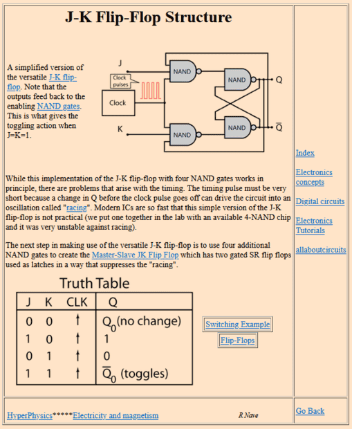

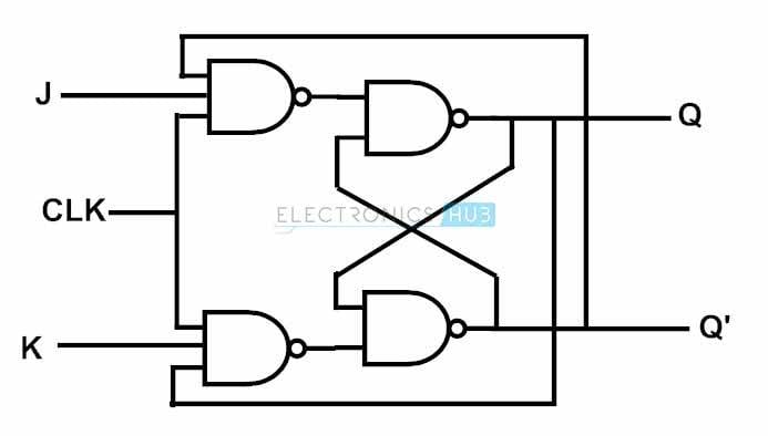

Our exercise in lab today was to construct a JK flip-flop using basic NAND gates. The ICs we used were 74LS00 and 74LS10. The circuit diagram we used is this:
We were, however, not getting the expected values of Q and Q' based on the values of J, K and CLK. For instance, in my case, CLK=1, J=1 and K=0 gave Q=1, as expected. But the moment I put CLK to GND, both Q and Q' went up to the HIGH state, irrespective of the values of J and K. We checked our circuit as well as the ICs, but there was no fault in either one.
Some other groups were facing the same issue as us, although for some specific set of input values only. Other groups were facing a different issue: suppose after setting J=1 and K=0, when they set J=1 and K=1 (the toggle state), both outputs went up to 1. In short, the toggle state was always giving Q=Q'=1.
The errors were occurring randomly, in the sense that not all groups had the exact same wrong output for a particular set of input values. If a group changed ICs, they often got the wrong output(s) for a different set of input values.
I brought two ICs home to see if I can re-create the issue. I used a 5V supply from an Arduino Mega. This is what I got:
The green rows indicate that the measured state is the same as the expected state. Red indicates that the measured state and expected state does not agree. The inputs are written exactly in the sequence they were applied. Hence, some input values are repeated. A number followed by "m" implies mV, otherwise V.
As you may see, this is not the same as what I got in class today. But I was getting the values consistently. E.g., if I set CLK=1, J=1 and K=1, I consistently got Q=Q'=1 irrespective of what the previous state was.

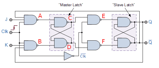

Some of my classmates were saying that a master-slave JK flip-flop will solve this. The Prof. hasn't given any answer yet.
Why is this happening? Race condition between the transistors used in the ICs? What can we do to prevent this?

Anyway, did you see the text in the HyperPhysics piece that I posted? That pretty much answers your questions.
Didn't see it at first. It does answer my question. I will update next Tuesday on how things went. Will also try to implement a debouncing circuit for the clock. (Today we used a 2-way switch for changing the states of CLK, one that is used with mains in houses.)

I brought the ICs home last week to construct the master-slave JK flip-flop. This is the logic circuit that I used:
The full schematic is given below. I have implemented the changes suggested by @Baluncore.
A few points regarding the schematic:
  • Yes, I am aware that it doesn't look good with all wires of the same colour, and it is difficult to understand which wire is going where. But none of the tools that I had (Fritzing, TinyCad or LibrePCB) was allowing me to create a schematic with 7400 ICs, not even online services. I had to take help of Digital to create this.
  • To make life a bit easier, I have labelled almost each and every wire going into and coming out of the ICs.
  • The voltage lines on the left and write signify the breadboard power lines.
  • All unused input lines have been grounded. These have been indicated by the label GND adjacent to their origin.
  • Every input, viz. J, K and CLK, was connected to HIGH only through a separate 1k resistor.
  • To connect the CLK to HIGH and LOW, I have used a 2-way switch, of the type shown here.
  • Two pull-up resistors have been attached to the outputs Q and Q' to allow voltages to be measured properly.
  • The bottom 7400 is of type HC; the others are of type LS.
  • I have not implemented a switch debounce circuit here. Discussed below.
It didn't work.
