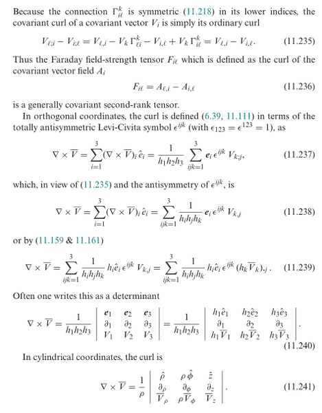

Alright, since the equation (1) is the Curl, I must do it in cylindrical coordinates. That is where I am making the mistake... If I follow (1) the way it is, it gives the Curl in Cartesian coordinates.
That paper calculates things in an orthonormal basis. Your original calculation involves a coordinate basis. You have to convert your results from one to the other depending on which you wish to work with. In your case this just involves a simple rescaling of the coordinate basis by appropriate factors of the metric in your original coordinates since the coordinate basis is mutually orthogonal. See my comment in post #4 about ##\epsilon^{\alpha\beta\gamma\delta}## as a tensor density vs. a symbol in the expression for the curl.

I tried to apply:
##\omega^{\alpha} = \epsilon^{\alpha\beta\gamma\delta}\xi_{\beta}\nabla_{\gamma}\xi_{\delta} = \epsilon^{\alpha\beta\gamma \delta}\xi_{\beta}\partial_{\gamma}\xi_{\delta}##
But got zeroes... are you sure it is the correct expression? Maybe was my Levi-Civita tensor.
