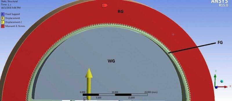

Hi everybody,
I'm working on an analysis model of flexible gear in ANSYS workbench.
This model has 3 components: flexible gear(FG), wave generator(WG) and rigid gear(RG)
Applied force have two case: WG makes FG deforming from circular shape to ellipse shape, the FG contacts and engages to RG for transferring torque or moment.
I used all contact type is frictional. Contact: FG, targets: WG or RG.
The specicial of this model is that FG and RG are not contact together in first time. After being deformation, FG can be connect to RG.
I try to solve model, but model didn't give me a stuitable results.
I wish that I have some help for my trouble!
Explain what you believe should be a suitable result as compared that the one shown.

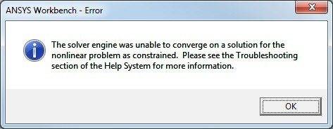

I try to set some non-linear condition for contact condition with medium meshing quality. And program shows me a error message.
