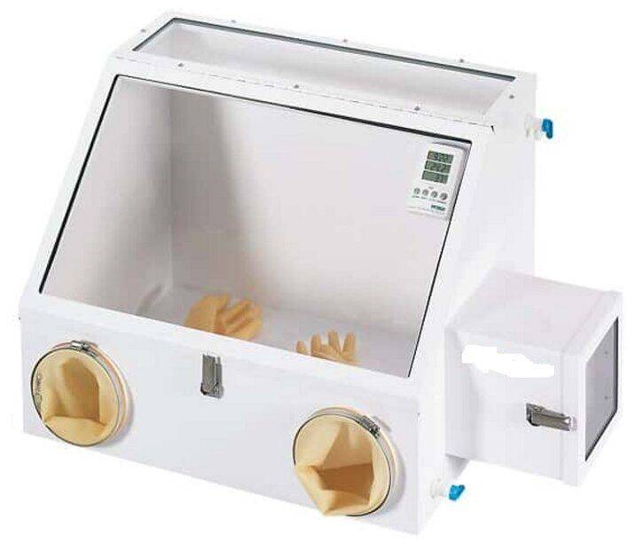

Could one design a enclosure that would allow you to maintain a specific helium level during 3/4 hours?
Hello experts,
First post here, and the reason I have found this forum is because I've spent the past few hours trying to figure something out.
I'm in the field of data recovery, and we are starting to see helium filled drives.
They are starting to be filled with HE due to factors like less drag inside the HDD.
Drives, sometimes require internal work. We do this everyday. However, when we work on a helium drive, after prying the case open we can only extract data for a few minutes before the read/write heads die due to operating on air vs HE.
Is there any way we could design such a enclosure that we could pump helium into, that would allow us to fully image the drives instead of using multiple sets of read/write heads per case?
Thank you for your inputs.
It sounds like you are looking for a glove box. It's a sealed box with built-in rubber gloves, a window, and an access port. You insert your drive, purge the air out using helium, then open the drive. This image is from a random hit using search term glove box:

Hi!
There is no need to operate on the device while it is running.
Ideally it would only be needed a box to purge oxygen and insert helium while the HDD is connected to a power and sata port.
If you don't need to actually handle the device in an helium atmosphere, then all you need is a reasonable vacuum-tight enclose with feedthroughs for the power and SATA and then a valve (probably a T-valve) that allows you to pump out most of the air (using e.g. membrane pump) and then a small Helium cylinder with a suitable regulator to back-fill.
Although I doubt you can find commercial off-the-shelf product that does this, you should be able to get a company specialising in custom vacuum products to make something suitable (there many such companies).
it should not be difficult to set up, but the person using it would still need a bit of training on how to use a regular and any H&S issues around compressed gases (this would be no different than for using protective gases for e.g. welding).
