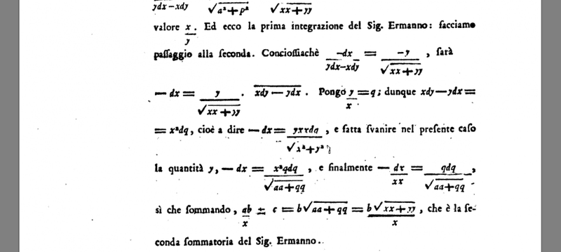

In summary, Riccati sets y/x=q and then arrives at x^2*dq. His formula is just given by multiplying dq = (x dy - y dx)/x2 by q2.
Poetria
267
42
Riccati sets y/x=q and then arrives at x^2*dq. This is his analysis of Jacob Hermann's differential equations criticised by Johannes Bernoulli (published in 1710).
x*dy-y*dx is a constant and is equivalent to dt.
I have understood everything except for the q-substitution.
Well, I have tried several times but all my solutions are not correct. E.g. x*dx*(dq-q). I have no idea how he got this square. I am missing some clues.

Perhaps you would find a more recent textbook easier to work from. :oldsmile: Ideal is roughly 1900-1970, after that they get more difficult again.
If I have understood right your missing thing is the standard formula for derivative of a quotient, one of the half-dozen practically learned off by heart by most calculus students, see any calculus textbook:
y/x = q
dq = d(y/x) = (x dy - y dx)/x2
His formula Is just given by multiplying dq = (x dy - y dx)/x2 by q2
y/x = q
Oh dear. What an idiot I am! Many thanks. :)
Oh, I think when you have not done it for a year or two it fades. In fact, I am often not that sure whether to write x dy minus... or y dx minus... and have to stop and think about it.
