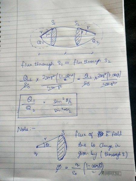

Not interested in the book, but here is a problem I find interesting.
Consider 2 point charges Q1 and Q2, separated by a distance d. (Q1> 0, Q2<0)If an electric field line originates from Q1 and makes an angle with the line joining the two charges near Q1(say ##\alpha##), then what angle would the same electric field line make near Q2?
Answer:
image.
