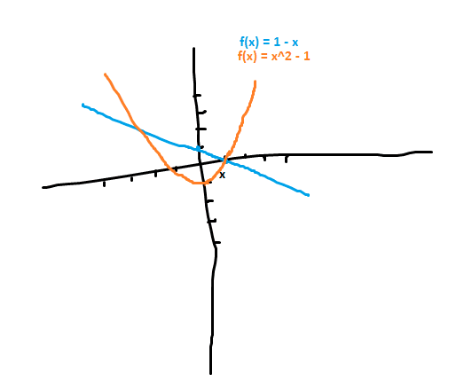

Consider the equation ##1-x=x^2-1## , the roots are the points where the function changes from one polynomial to the other. In between the roots which polynomial is bigger? So after you answer that, just check for continuity and differentiability at those points by computing the left and right limits and the left and right derivatives.

Sketch it! Sketch f = (x - 1) and f = (x2 - 1) and on top make the actual given function bold. You might have some trouble formalising a proof argument, but at least you won’t have any doubt what the answer is.

If I take 1-x = x2 - 1 Roots of this equation are -2 and 1
For x = -2
1 - x = 1 + 2 = 3
x2 - 1 = 4 - 1 = 3
For x = 1
1-x = 0
x2 - 1 = 0
Between roots. So I take point x = -1
Now:
1 - x = 1 + 1 = 2
x2 - 1 = 1 - 1 = 0
So 1 - x is bigger.
Plotting graph i get this:
Now what to do? I don't even understand the options.

It looks continuous everywhere. and even differnetiating is easy. 1 - x derivative is -1, and x^2 - 1 derivative is 2x.
I get option B but answer option is C.

Yes. No gaps or anything. Formally you have to show that ##f(-2)=g(-2)## and ##f(1)=g(1)##. The other areas are polynomials, so they are both, continuous and differentiable there, as you mentioned:
... and even differnetiating is easy. 1 - x derivative is -1, and x^2 - 1 derivative is 2x.
Before you draw conclusions, what happens at ##x=-2## and at ##x=1\,?## Gaps? Vertices? And what does this mean?
Likes jaus tail
It is continuous everywhere. But at x=-2 the right derivative is -1 but the left derivative is 2x=-4. At x=1 the left derivative is -1 but the right derivative is 2x=2.

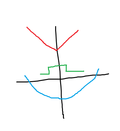

To be honest I said it's continuous everywhere cause it looks so in graph. I didn't really understand what it means. I mean i know that if a function has sharp turns then it's discontiuous. But what do gaps mean here?
Of the three functions above, only blue one is continuous right?
What about yellow one? It's y = mod x

No you are confusing differentiability and continuity. If the graph looks connected (i.e. we can draw it without lifting up our pencil), it is continuous. If in a point, there is a sharp turn, it is not differentiable in that point.
Likes Delta2 and jaus tail
The thumb rule is: if you can draw it without lifting the pencil, then it's continuous. (Of course there are pathological functions where this is not true, but here it is.) I recommend to look up the formal definition of what continuity means, e.g. on Wikipedia. Then you should try to formally prove continuity of ##m(x)## at e.g. ##x=-2##.
