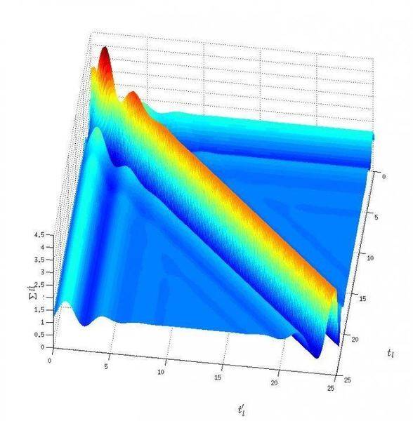

My covariance function looks like this:
A simpler example, where the problem of an ill-defined inverse arises, is
[tex] \Sigma(t,t') = \exp(-(t-t')^2) [/tex]
If one could understand why this fails in contrast to e.g.
[tex] \Sigma(t,t') = \exp(-|t-t'|)[/tex] or [tex] \Sigma(t,t') = 1-|t-t'| [/tex]
where the inverse exists, a solution might be possible to find.These processes are of course stationary, but I believe the root of my problem is the same.
