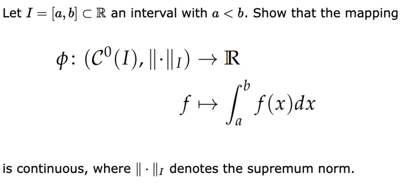

Show that the mapping ##\phi## is continuous
none
Hi,
I don't know if I have solved task correctly
I used the epsilon-delta definition for the proof, so it must hold for ##f,g \in (C^0(I), \| \cdot \|_I)## ##\sup_{x \in [a,b]} |F(x)-G(x)|< \delta \longrightarrow \quad |\int_{a}^{b} f(x)dx - \int_{a}^{b} g(x)dx |< \epsilon##
I then proceeded as follows
##|\int_{a}^{b} f(x)dx - \int_{a}^{b} g(x)dx | =|F(b)-F(a)-G(b)+G(a)|=|F(b)-G(b)+G(a)-F(a)|##
Then I used the supremum norm to estimate the above expression ##|F(b)-F(a)-G(b)+G(a)|=|F(b)-G(b)+G(a)-F(a)| \le \sup_{x \in [a,b]} |F(x)-G(x)|+\sup_{x \in [a,b]} |F(x)-G(x)|+\sup_{x \in [a,b]} |G(x)-F(x)|=2\sup_{x \in [a,b]} |F(x)-G(x)|<2\delta## it then follows that ##\delta## must be defined as follows ##\delta= \frac{\epsilon}{2} ##
You want to find a ##\delta## such that if ##||f-g|| = \sup_{x \in I}|f(x)-g(x)| < \delta## then ##|\phi(f) - \phi(g)|< \varepsilon##. It seems to me that you have instead used the primitive function of ##f## and ##g## in the supremum norm.

Hint: By basic properties of the Riemann integral, [tex]
\left| \int_a^b f(x)\,dx \right| \leq \int_a^b |f(x)|\,dx \leq (b- a) \sup |f|.[/tex]

I have now used the tip from pasmith and received the following
The following must apply:
##\sup_{x \in [a,b]} |f(x)-g(x)|< \delta \longrightarrow \quad |\int_{a}^{b} f(x)dx - \int_{a}^{b} g(x)dx |< \epsilon##
Then I determined ##\delta## as follows
$$|\int_{a}^{b} f(x)dx - \int_{a}^{b} g(x)dx \le |\int_{a}^{b} |f(x)|dx - \int_{a}^{b} |g(x)|dx \le (b-a) \sup f|x|-(b-a) \sup |g(x)| = (b-a) \bigl( \sup|f(x)| - \sup|g(x)| \bigr)$$
Then ##\delta## must be ##\delta = \frac{\epsilon}{b-a}##

The first inequality is incorrect.

That all looks ill-conceived to me. For example, I don't think you've corrently identified the metric that is derived from the given supremum norm.
PS as pointed out in post #2.
Likes Lambda96 and docnet
[tex]|\phi(f) - \phi(g)| = \left| \int_a^b f(x)\,dx - \int_a^b g(x)\,dx \right| = \left| \int_a^b f(x) - g(x)\,dx\right| [/tex] etc.

$$ \bigg \vert \int_{a}^{b} f(x) dx - \int_{a}^{b} g(x)dx \bigg \vert= \bigg \vert\int_{a}^{b} f(x)-g(x) dx \bigg \vert \le \int_{a}^{b} |f(x)-g(x)| dx \le (b-a) \sup|f(x)-g(x)|$$
From this follows ##\delta=\frac{\epsilon}{b-a}##

That's fine as far as it goes, but you really need a sound, logical proof. All ##\epsilon-\delta## proofs, in principle, should start with "Let ##\epsilon > 0 \dots ##".

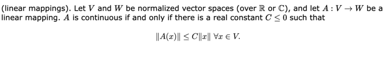

For the above problem, I had decided to use the proof for the epsilon delta definition, as my lecturer told me that I would have to know it for the exam.
According to my professor's lecture notes, if the mapping is linear, you can also use boundedness to prove continuity
Do you see the close relationship between the proof of that theorem and the proof in this particular case?
