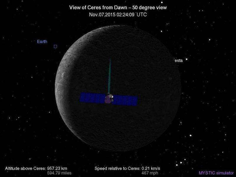

Sample simulated view of Dawn spacecraft retrothrusting so as to spiral in closer to Ceres, as anorlunda mentioned:
This is the view as of around 6:25 PM pacific time on 6 November. (UTC is 8 hours ahead of pacific time).
Dawn is in roughly polar orbit and is heading north to pass above Ceres north polar region, after which it will come south over the dayside.
