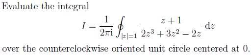

I've tried this using the definition of a contour integral and Cauchy's residue theorem but get conflicting answers.
[itex]\displaystyle f(z) = \frac{z+1}{z(2z-1)(z+2)}[/itex]
We can parametrise the contour [itex]\gamma[/itex] (the unit circle) by [itex]\gamma(t) = e^{it}[/itex] for [itex]t \in [0, 2\pi ][/itex]
So by the definition of a contour integral
[itex]2\pi i \times I = \displaystyle \int^{2\pi}_0 \frac{e^{it}+1}{2e^{3it} + 3e^{2it} - 2e^{it}} \times ie^{it}\;dt = \frac{\pi i}{5}[/itex]

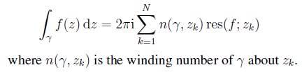

But using the residue therem
[itex]\displaystyle \text{res}(f,0) = -\frac{1}{2}[/itex]
[itex]\displaystyle \text{res} \left( f,\frac{1}{2} \right) = \frac{6}{5}[/itex]
[itex]\displaystyle \text{res} (f,-2) = -\frac{1}{10}[/itex]
[itex]\gamma[/itex] wraps once (in the negative direction) around [itex]z=0[/itex] and [itex]z=\frac{1}{2}[/itex] so [itex]n (\gamma, 0) = n (\gamma, \frac{1}{2}) = -1[/itex] and [itex]n (\gamma, -2) = 0[/itex]
So [itex]\displaystyle 2\pi i \times I = 2\pi i \left(-\frac{1}{2} \times -1 + \frac{6}{5} \times -1 \right) = -\frac{7\pi i}{5}[/itex]
which is not what I got before.

You are going around counterclockwise. I don't think that makes the winding number -1. And Res(f,1/2) isn't 6/5. Can you show how you got that?
You have to use the residue theorem in this case because of the singularity at z = 0. Assuming the residues were calculated correctly, the second answer is correct.

You don't HAVE to use residues. The answer in the first method is correct. Though I don't know how it was done. Probably by typing into Wolfram Alpha or something. And the residues aren't correct. That's the big problem. Sometimes I think it should be a rule here that people actually work a problem out before feeling qualified to give advice.

Oh, I didn't mean to ridicule. Sorry. But still, there is a fairly specific problem here that generalized 'group brainstorming' isn't going to catch.
res(f,1/2) should be 3/5 and the winding numbers should be 1 (anticlockwise means 'positively oriented'), so I think this is now correct:
[itex]\displaystyle \text{res} \left( f,\frac{1}{2} \right) = \frac{3}{5}[/itex]
[itex]\gamma[/itex] wraps once (in the negative direction) around [itex]z=0[/itex] and [itex]z=\frac{1}{2}[/itex] so [itex]n (\gamma, 0) = n (\gamma, \frac{1}{2}) = 1[/itex] and [itex]n (\gamma, -2) = 0[/itex]
So [itex]\displaystyle 2\pi i \times I = 2\pi i \left(-\frac{1}{2} \times 1 + \frac{3}{5} \times 1 \right) = \frac{\pi i}{5}[/itex]
So [itex]I = \frac{1}{10}[/itex]
I typed the first integral into Wolfram Alpha merely to check whether the 2 answers agreed, which they didn't!
