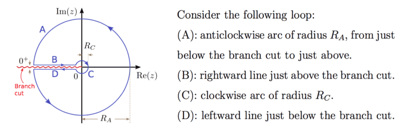

I am supposed to evaluate the contour integral of the positive branch of ##z^{-1/2}## over the following contour:
I believe the answer should be 0, by Cauchy's theorem (loop encloses no poles), but my methods of parameterization have led to non-zero answers.
Here are the following parameterizations I have tried so far,
A) Loop parameterized by ##z = R_A e^{i\theta}## from ##\theta = -\pi## to ## \pi##
B) Line parameterized by ##z = Re^{i\pi}## from ##-R_A## to ##-R_C##
C) Loop parameterized by ##z = R_C e^{i\theta}## from ##\theta = \pi## to ## -\pi##
D) Line parameterized by ##z = Re^{-i\pi}## from ##-R_C## to ##-R_A##
I believe that I am actually doing integrals on the cut by using this method (hence an incorrect answer), but I can't seem to find a way to avoid the cut and am therefore stuck.
Any advice is greatly appreciated
To stay away from the cut, the first arc mustn't go from ##-\pi## to ##\pi## but from ##\epsilon-\pi## to ##\pi-\epsilon##, where ##\epsilon ## is a small angle.
Then you can parameterise B and D as horizontal lines at heights ##\pm y_B## that are trig functions of ##R_A## and ##\epsilon## and starting and ending at horizontal coordinates ##x_A,x_C## that are respectively functions of ##(R_A,\epsilon)## and ##(R_C,y_B)##. Finally, you need to work out a new angle ##\psi## that is a function of ##(R_C,y_B)## so that ##\pm \psi## are the integration limits for curve C.
Write a formula for the total integral, which will be a function of ##R_A,R_C## and ##\epsilon##. Then work out the limit of that formula as ##\epsilon\to 0##.
EDIT: We can simplify the process by getting rid of the parameter ##R_C## and instead having the loop C go around the origin at radius ##y_B##, joining to the lines B and D tangentially rather than with a kink. Then ##x_C=0## so that loop C and lines B, D all end neatly on the y axis.
Thanks very much! I'll give it a shot. Appreciate the help.
Would I be right in saying that working in terms of ##\pi## instead of ##\pi + \epsilon## means working on the cut?
Yes.
