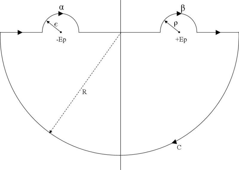

OK, since I'm doing it explicitly myself, I'll post as much as I can here, and hopefully all you have to do is say "Correct!"
Using the figure below, we'll close the contour below with an arc C of radius R, and let the two semicircles be [itex]\alpha[/itex] and [itex]\beta[/itex] about the poles at [itex]E_p[/itex] and [itex]-E_p[/itex], of radius [itex]\epsilon[/itex] and [itex]\rho[/itex], respectively, so that the total contour is
$$\oint_{Total} = \int_{-R}^{-E_p-\epsilon}dp^0 + \int_\alpha + \int_{-E_p+\epsilon}^{E_p-\rho}dp^0 + \int_\beta + \int_{E_p+\rho}^R + \int_C$$.
Now, let's evaluate the separate parts for the function
$$\frac{-1}{z^2 -E_p^2} e^{-iz(x^0-y^0) -i\mathbf{p}\cdot(\mathbf{x-y})}$$
where we use coordinates [itex]z=p^0 + iv[/itex].
Firstly, we are going to use the residue theorem, so note that
$$\frac{-1}{z^2 -E_p^2} e^{-iz(x^0-y^0) -i\mathbf{p}\cdot(\mathbf{x-y})} = \frac{-1}{(z-E_p)(z+E_p)} e^{-iz(x^0-y^0) -i\mathbf{p}\cdot(\mathbf{x-y})}$$
so has poles at [itex]\pm E_p[/itex] with residues [itex](-1/2E_p)\ e^{-iE_p(x^0-y^0) -i\mathbf{p}\cdot(\mathbf{x-y})}[/itex] and [itex](+1/2E_p)\ e^{+iE_p(x^0-y^0) -i\mathbf{p}\cdot(\mathbf{x-y})}[/itex]. Hence, the residue theorem tells us that
$$\oint_{Total} \frac{-1}{z^2 -E_p^2} e^{-iz(x^0-y^0) -i\mathbf{p}\cdot(\mathbf{x-y})} = -\frac{2\pi i}{2E_p}\left[-e^{-iE_p(x^0-y^0) -i\mathbf{p}\cdot(\mathbf{x-y})} + \ e^{+iE_p(x^0-y^0) -i\mathbf{p}\cdot(\mathbf{x-y})}\right].
(Note the minus sign as we're going the wrong way round the contour.)
Secondly, for the large arc C, we can use Jordan's lemma. Note that, for sufficiently large R,
$$\left|\frac{-1}{z^2 - E_p^2} e^{-ip\cdot(x-y)}\right|= \frac{1}{R^2-E_p^2}\quad\forall |z|=R$$
which clearly tends to zero as [itex]R\to \infty[/itex]. Furthermore, given that we have a lower semicircular integral of the form
$$\int_C e^{-iaz}f(z)dz$$
then as long as [itex]a>0[/itex], we may apply Jordan's lemma. That is,
$$\int_C \frac{-1}{z^2 - E_p^2} e^{-iz(x^0-y^0) -i\mathbf{p}\cdot(\mathbf{x-y})} \to 0\quad\text{as }R\to\infty$$
as long as [itex]x^0-y^0>0[/itex]. So that first piece is solved.
Finally, let's consider the contour around [itex]\alpha[/itex], which we parameterise by [itex]z = -E_p + \epsilon e^{i\theta}[/itex]. Hence
$$\int_\alpha \frac{-1}{z^2 -E_p^2} e^{-iz(x^0-y^0) -i\mathbf{p}\cdot(\mathbf{x-y})} = -\int_0^\pi d\theta i\epsilon e^{i\theta} \frac{-1}{(-E_p + \epsilon e^{i\theta})^2 -E_p^2} e^{-i(-E_p + \epsilon e^{i\theta})(x^0-y^0) -i\mathbf{p}\cdot(\mathbf{x-y})}= i\int_0^\pi d\theta \frac{1}{(\epsilon e^{i\theta}-2E_p)} e^{iE_p(x^0-y^0) + i\epsilon e^{i\theta}(x^0-y^0) -i\mathbf{p}\cdot(\mathbf{x-y})}$$
(Note the extra minus as we're going the wrong way round the contour.) Now, as [itex]\epsilon\to 0[/itex] we see
$$\lim_{\epsilon\to 0}\int_\alpha \frac{-1}{z^2 -E_p^2} e^{-iz(x^0-y^0) -i\mathbf{p}\cdot(\mathbf{x-y})} = i\pi\frac{1}{-2E_p} e^{+iE_p(x^0-y^0) -i\mathbf{p}\cdot(\mathbf{x-y})}=i\pi Res(-E_p)$$
(Note that this result is a general one.) Similarly for [itex]\beta[/itex]
$$\lim_{\rho\to 0}\int_\beta \frac{-1}{z^2 -E_p^2} e^{-iz(x^0-y^0) -i\mathbf{p}\cdot(\mathbf{x-y})} = i\pi\frac{1}{2E_p} e^{-iE_p(x^0-y^0) -i\mathbf{p}\cdot(\mathbf{x-y})}=i\pi Res(E_p)$$
The last thing we need is the concept of the Cauchy principal value integral: http://mathworld.wolfram.com/CauchyPrincipalValue.html, which means that
$$P.V.\int_{-R}^R dp^0 = \lim_{\epsilon\to 0,\rho\to 0}\left[\int_{-R}^{-E_p-\epsilon}dp^0 + \int_{-E_p+\epsilon}^{E_p-\rho}dp^0+\int_{E_p+\rho}^R dp^0\right].$$
Finally, putting everything together in the limits [itex]\epsilon\to 0,\ \rho\to 0,\ R\to \infty[/itex] gives
$$P.V.\int_{-\infty}^\infty dp^0 = \oint_{Total}-\int_\alpha-\int_\beta -\int_C = -\frac{2\pi i}{2E_p}\left[-e^{-iE_p(x^0-y^0) -i\mathbf{p}\cdot(\mathbf{x-y})} + \ e^{+iE_p(x^0-y^0) -i\mathbf{p}\cdot(\mathbf{x-y})}\right] - i\pi\frac{1}{-2E_p} e^{+iE_p(x^0-y^0) -i\mathbf{p}\cdot(\mathbf{x-y})} -i\pi\frac{1}{2E_p} e^{-iE_p(x^0-y^0) -i\mathbf{p}\cdot(\mathbf{x-y})} - 0$$
That is
$$P.V.\int dp^0\ \frac{-1}{p^2 -m^2} e^{-ip\cdot(x-y)} = \frac{\pi i}{2E_p}\left[e^{-iE_p(x^0-y^0) -i\mathbf{p}\cdot(\mathbf{x-y})} - \ e^{+iE_p(x^0-y^0) -i\mathbf{p}\cdot(\mathbf{x-y})}\right].$$
Unfortunately I am out by a factor of two from the correct answer of (2.54) in PS. However, I am way past tired, so need to hit the hay --- if somebody finds my error, I'd appreciate if you can let me know, and I'll edit my post tomorrow.
Furthermore, note how I've only got the result for the principal value integral...I recall reading somewhere that it equals the usual integral if it the function is Lebesgue-integrable. I don't know what this means, but if someone does, and could confirm the function in question is, I'd be tickled pink.
Lastly, I haven't read this yet, but the following describes how the "cheating" strangerep was referring to may actually be notational (see page 14 or so of pdf): http://hitoshi.berkeley.edu/221a/contour.pdf.
At this stage, I'll just make a few suggestions...
1) You can factor out the exponential involving spatial components.
So they don't affect the energy integral.
2) You can cut down on the mess enormously by using some different symbols
for the purposes of performing the integral. E.g., you could start with
$$ \int\!dz\; \frac{e^{ikz}}{z^2 - a^2} $$ where ##k,a## are both real.
That should reduce your typing considerably.
3) Your application of Jordan's lemma is a bit sloppy, since you don't
actually evaluate the the maximum value of the denominator on the large
semicircle.
4) Your treatment of the small semicircles around the poles is quite wrong.
You can't use the residue theorem here unless you've got a closed circle
around the poles, but you've only got two little semicircles. (The treatment
in that contour.pdf file you linked to is sloppy in this regard, since it
assumes certain symmetry on the upper and lower sides of each pole.)
To do it properly, you'll need to do each semicircle properly as a line integral.
Set ##z=r e^{i\theta}## with ##r## constant, and do a ##\theta## integration
accordingly. The integrand must be Laurent-expanded around each pole first,
so that you can subsequently take a limit as ##r\to 0##.
5) If you use a slightly different contour by avoiding the poles via
semicircles in the lower half plane, you won't have to evaluate any residues
at all, since the new contour encloses no poles. If you evaluate the small
line integrals correctly, you'll get the right answer.
6) I just found my old notes where I evaluated this same integral, so I can
probably post it if you get stuck. Item 5 above can be a bit tricky if you
haven't seen it done before, but I'll let you have a go at it first. :-)
7) Regarding the Lebesgue-integrable thing... it's insensitive to integration
on "sets of measure zero" (i.e., single points in this case). So you can
exclude the isolated poles on the real axis. I hope that makes sense.

I only used the residue theorem for the complete closed loop integral, which certainly includes the two poles. So I don't follow that point.
Secondly, I did parameterise each semicircle exactly as you said. I'm not sure if what I did was "Laurent-expanded", but it seems right to me. So I don't really follow this point either.

[...] I think I did the integration on the semicircles correctly, but maybe you skimmed over it?
Unbelievable! Now it's my turn to use the "I was way past tired" excuse. Yes, I did indeed skim too fast. (Maybe I wouldn't have if there weren't so many symbols floating around, but, oh, that's a lame excuse.) I'll try to check your factors of 2 later after I wipe the egg off my face.

Start with the simpler integral I mentioned earlier, i.e.,
$$I_1 ~:=~ \int_{-\infty}^{+\infty} \!\! dz \; \frac{e^{ikz}}{z^2 - a^2}$$
where ##k,a## are real nonzero constants, with ##k>0##.
(But don't refer to your previous work while doing this, so as not to bias the calculation.)
Do it two ways:
1) with a contour that takes little detours around the poles in the upper halfplane (and hence encloses both poles),
2) with a contour that takes little detours around the poles in the lower halfplane (and hence encloses no poles).
Do you get the same answer in both cases, and is the answer compatible with what you had before?
Then do it twice more with modified denominators:
(i) ##z^2 - a^2 + i\epsilon z##
(ii) ##z^2 - a^2 + i\epsilon##
Check where each of these moves the poles, and what the contour integral results are in both cases.

But your solution to the first problem cannot be completely right. If you enclose no poles, the result is 0.
Note that you must close the contour in the upper [itex]z[/itex] half-plane. So for contour 1 you get 0, because in that case there are no poles inside the contour (contrary to what strangerep said in his question). If you close the contour in the lower half-plane the exponential blows up along the semi circle there!
In the second case both poles are within the contour, and then you have according to the residue theorem (I take [itex]a>0[/itex] to make the notation simple)
[tex]\int_{\mathcal{C}_w} \mathrm{d} z \frac{\exp(\mathrm{i} z k)}{k^2-a^2}=2 \pi \mathrm{i} \left [\frac{\exp(\mathrm{i} k a)}{2a}-\frac{\exp(-\mathrm{i} k a)}{2 a} \right ]=-\frac{2 \pi}{a} \sin(k a).[/tex]
So here you have a factor 2 wrong.

so, what we do is we tell you how to fix that, by giving a pole prescription
(a path that skirts the poles). what you're calculating is the principal value integral. this
is NOT what p&s tells you to calculate, so of course you're getting different answers.
qbert said:
and that's where you're going wrong. the part along the real axis of the integral is undefined.
Ah, that makes things a little clearer! So, it should not really be
$$\int \frac{dp^0 }{2\pi i}\frac{-1}{p^2 - m^2}e^{-ip\cdot (x-y)}$$
but
$$\int_C \frac{dz }{2\pi i}\frac{-1}{z^2 - E_p^2}e^{-iz(x^0-y^0) -i\mathbf{p\cdot (x-y)}}$$
where ##C## is the contour given. Actually, as far as I'm aware ##C## could be any (anticlockwise) contour that surrounds both poles (for retarded propagator), as by the residue theorem, the result is the same. The contour could even be a circle around the poles, and only crosses the real axis, but does not lie upon it.
Anyway, I think strangerep and I are correct if it is an integral along the real axis (yes, I discussed that it was only the principal value, and strangrep indicated this was the same as the usual integral in this case). Otherwise, I agree with you if it is not an integral along the real axis, but one along the contour ##C##.
Another point to mention: the principal value is (clearly) the same regardless of the four possible contours (i.e. Feynman = advanced = retarded propagators). So it must require the contour specific prescription you advise.
Cheers
exactly right.
you have to specify the contour for the principal value too.
it is: integrate up to pole - ε, integrate from pole + ε, up --
then take limit as ε goes to 0. which has the advantage
of never leaving the real axis, but the disadvantage of
being 1 a broken path, and 2 defined in terms of a limiting
operation.
but let me repeat the integral along the real axis is undefined
until you give a pole prescription. as a real integral it is
undefined as written. there is no "usual integral" in this case,
you have to figure out some way to handle the poles.
qbert said:
exactly right.
operation.
Sorry, I edited that post with the comment about it being any possible contour ##C## --- do you agree with this?
You don't really need to specify the contour for the principal value --- by definition, it is the one you described, in the same way the contour for a real integral is along the real axis.
I admit that the principal value integral didn't sit well with me. However, strangerep implies that in this case the principal value was the same (post #10, point 7). If this is true, then I am fine with this --- do you agree it is true?
Lastly, am I right in saying that the point of the complex integration is simply to shorten the formula? PS give the non-complex formula in (2.54), but it can be shortened with the complex integral. In this sense, I take back my prior statement that the propagator "depends" on the contour chosen --- the propagators themselves are different due to how they are derived etc, and it just turns out that these different formulae can be written in the same form, but with complex integrals and specific different contours.
1. you DO have to specify a path for the principal value -
it's the one i mentioned with SYMMETRIC limits. you
don't have to think about it AS a path - but it is.
otherwise the integral is UNDEFINED. So when you
say it's that one "by definition", what do you think
the "definition" is for?
2. there is no USUAL integral in this case. Lebesgue or not.
3. The point of the complex integration is to tell you how
to define an undefined integral. You can think about it
as a clarifying statement. writing [itex]\int_{-\infty}^\infty[/itex] doesn't mean anything
in this case. The contour tells you what ∫ means.
4. P&S want to write the integral as a space-time integral,
so in one sense they're just rewriting.
But at every point it's a well defined integral. As they go from
the second to the last line to the last
when they write the dp0 integral they HAVE to tell
you which contour to pick. that's why they have the whole
paragraph after 2.54 explaining how they're writing the
integral and give a pole prescription.
as to point 1.

[tex]
\text{p.v.}'\int_{-\infty}^\infty \frac{e^{-|x|}}{x} dx = \ln(2).
[/tex]

That's only true if the total contribution from the small detouring semicircles around the real poles is zero. In the partial solutions so far, that has not been proven.
I think what's been said is that we are not trying to find the integral in the limit of smaller semicircles. That is the path, and they are meant to be of finite radius. (I'm still waiting to hear if they can be any anticlockwise contour surrounding the poles.) Hence, the residue theorem works fine.
  • #32
Regarding the point about defining the integral correctly... of course we intend
the Cauchy principal value interpretation of the integral. I.e., the ill-defined integral
I_1 ~:=~ \int_{-\infty}^{+\infty} \!\! dx \; \frac{e^{-ikx}}{x^2 - a^2}
is tacitly interpreted as
\def\eps{\epsilon}
I_1 ~:=~ P.V. \int_{-\infty}^{+\infty} \!\! dx \; \frac{e^{-ikx}}{x^2 - a^2}
~\equiv~
\lim_{\eps\to 0} \left(\,
\int_{-\infty}^{-a-\eps}\!\!\!\!\dots
~+~ \int_{-a+\eps}^{a-\eps} \!\!\!\!\dots
~+~ \int_{a+\eps}^{+\infty}\!\!\!\!\dots \;\right) ~,
to be performed by contour integration in the complex ##x##-plane.
Cf. http://en.wikipedia.org/wiki/Cauchy_principal_value
Any use of such complex energies, etc, is only a technical device, since complex
energies (in this context, at least) are unphysical. To be physically useful, the
result for ##I_1## must not depend on which technical device we choose.
The Cauchy PV interpretation, combined with contour integration satisfies
this criterion, since it doesn't matter which way we choose to form a closed
contour (provided the total contour integral exists, of course, and that any extra
detours in the complex plane are accounted for when isolating the
contribution from ##I_1## which is what we want).

OK, I'm getting confused by the opposing views presented, but I think posts #23 and #24 clarify things. The principal value approach would be correct if attempting to evaluate along the real axis (principal value is and is not (?) the same as the real integral, from what I've been told). However, PS are not talking of this integral. They are talking of ##\int_C## where ##C## is the given (or possibly more general) contour around the poles.
strangerep, thanks for the list of errata --- most useful!
  • #35
Your second expression is the same as
$$\frac{\pi i}{a} \Big( e^{ika} - e^{-ika} \Big)$$
which is the same as Ian's result (except for a minus sign at the front which I think is due to the different contour orientations). But I don't see a "factor of 2" error here. (?)
