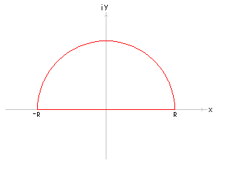

The integration contour You have to choose is represented in red here...
... so that, if R tends to infinity, all the poles with imaginary part >0 are involved...

I made a sub $t=\frac{\pi x}{2}$ and arrived at
$$\frac{1}{2\pi}\int_{0}^{\infty}\frac{1}{(t^{2}+1)cosh(\frac{\pi t}{2})}$$
There is an identity that says $$\frac{1}{2\pi}\int_{0}^{\infty}\frac{1}{(t^{2}+1)cosh(at)}dt=\sum_{n=1}^{\infty}\frac{(-1)^{n-1}}{2a+(2n-1)\pi}$$.
It is derived from the poles being at $\frac{(2n-1)\pi i}{2a}$. Then, the residue turns out to be:
$\frac{(-1)^{n-1}4ia}{4a^{2}-\pi^{2}(2n-1)^{2}}$. Now, using the residue theorem and expanding gives the aforementioned series.
Letting $a=\frac{\pi}{2}$ gives $$\sum_{n=1}^{\infty}\frac{(-1)^{n-1}}{2n\pi}=\frac{1}{2\pi}\sum_{n=1}^{\infty}\frac{(-1)^{n-1}}{n}=\frac{ln(2)}{2\pi}$$
This is in a paper I have on hyperbolic integrals by Gradshteyn and Ryzhik. Though, it still seems to me that a rectangular contour is a possibility.
