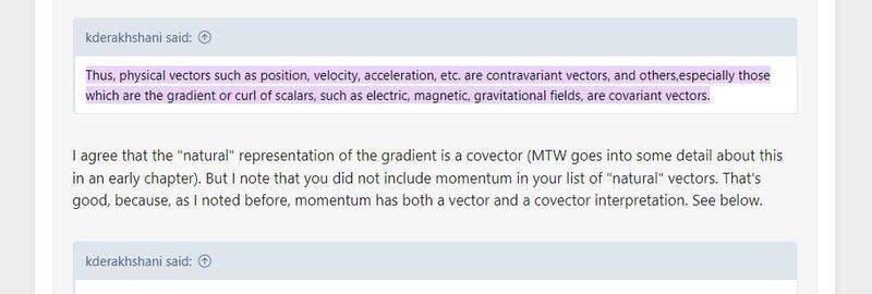

In a post
Reference: https://www.physicsforums.com/threads/contravariant-and-covariant-vectors.735287/
This was said: (see picture)
So, then he skirts the issue by using the word "natural"
I am still confused how he asserst that a position vector is contravariant.
And now I want to konw what "natural" means, with regard to the gradient (and I do understand it has contra and co forms with the metric tensor, etc.), but what does he mean by "natural" and can that address the issue of why so many people call the positio vector contravariant (and yes, I know vectors are physical objects)

Trying2Learn said:
In a pos
As I said, that's just the sloppy slang of physicists, who don't distinguish between vectors (independent of any choice of basis) and components of vectors (dependent on the choice of basis they are related to). Once more a position vector (or any other vector) doesn't change at all under a change of basis but their components of course do.
The statement of "natural" must refer to components too. Indeed a gradient (or rather the components of the gradient) of a scalar field is most simply given in terms of covariant components. If you choose a coordinate basis of the tangent vectors on a manifold then derivatives with respect to the coordinates, ##q^j##, the partial derivatives ##\partial_j \Phi(q)=\frac{\partial}{\partial q^j} \Phi(q)## transform as covariant vector components do.
So, with that, are you suggesting that when we take the gradient, it INITIALLY (using frames of reference to which we are accustomed BEFORE studying contra/co) seems that the gradient components transform covariantly...
And that, (in accordance with our first learning), position vector has components that appear to transform contravariantly.
However, in the long-run, either vector can be described in terms of components that transform contra or co, (as long as we use the correct basis or dual), equipped with the metric tensor to raise or lower the indices (change the variance)
Because it seems to be that the use of the word "natural" is causing me just as much grief.
