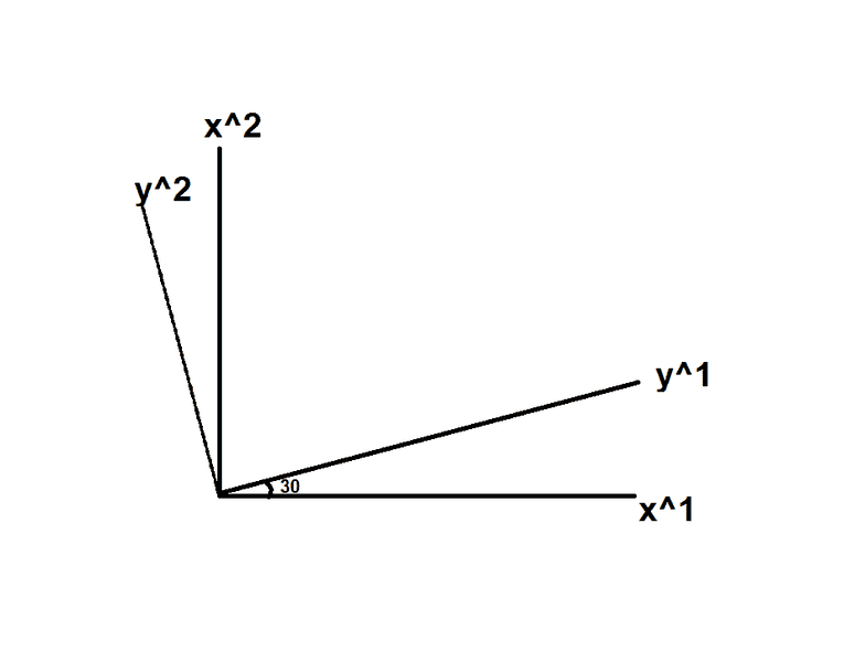

About trying to write the equation in that format I think the problem maybe that I'm not writing it down correctly.
In my coordinate system transformation (which I've attached) am I right in saying that
[itex] y^1 = \frac{1}{\sqrt{3}}x^1 [/itex] because [itex]y^1[/itex] is essentially a straight line with a gradient of [itex]\frac{1}{\sqrt{3}}[/itex]?

Yeah, if [itex]dy^1 = \frac{\sqrt{3}}{2} dx^1 + \frac{1}{2}dx^2[/itex] then your partial derivatives are correct since the partial derivative with respect to one variable is just what you get when you set the 'd'*other variables to zero
For your transformation equation, think about what happens to your position in the y coordinates as you increase x1 then when you increase x2, each time you change your x1 coordinate you are changing your position in both of the y coordinates, if you understand what I mean.
if you move from x1=0 to x1=3, you've increase your y1 position but you've also decreased your y2 position since you are not below the y1 axis
Ah! I think I get it!
I've been considering the cartesian equation instead of the vector equation!
So [itex] y^1 = \frac{\sqrt{3}}{2} x^1 + \frac{1}{2} x^2 [/itex] !
Then I can get [itex]\frac{∂y^1}{∂x^1} = \frac{\sqrt{3}}{2}[/itex] and [itex]\frac{∂y^1}{∂x^2} = \frac{1}{2}[/itex]
Yes, I get it now. Thanks a lot for helping me!
