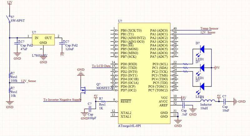

Hello, I've been trying to figure out how to design a control circuit for a project of mine with no success. I could use a little guidance.
The proposed circuit is a board powered by a simple 9V battery. It will have a temperature probe connected to it. The circuit is supposed to close and open a 12VDC connection (i.e. wire from the negative terminal of a car battery) based on the temperature, thus:
- close the circuit if temperature is equal to or less than -19 degrees Celcius
- open the circuit if temperature is greater than -15 degrees Celcius
The board will have a simple SPST on/off switch. It will also (when on) measure the car battery's voltage and display it in a digital readout and also display the temperature probe's reading.
Finally, there will be a green lamp blinking when the circuit is closed, and a red lamp on solid if the car battery voltate is 5VDC or less.
I was wondering if anyone would be willing to help me out in getting this thing started?

Necessity being the mother of invention, I decided I had enough of people stealing my vehicle's block heater extension cord and had the great idea of making an automatic system for heating an engine's coolant during extreme cold where you need your vehicle to start no matter what.
The board controls the connection from the 12VDC car battery to the power inverter.
I can attach schematic if required for clarity.

The schematic...

Darendor,
I'm not certain if the rest of your post was derisive sarcasm or not, but all I really wanted was some pointers on getting my control unit going since I've never delved into this before.
My post was an assessment of the cost to benefit ratio of your project with specific examples to validate it. If you want to proceed with your project as outlined in the OP, then I would suggest you begin by choosing a uController; it is by far the easiest solution to the various functions you want your box to perform. I would suggest the AVR family, I like the ATMega16 and 32 as general platforms, though you could certainly use a less robust model.
I would simultaneously work on the firmware and the analog segments of the project. You can use the on board ADCs for temperature sensing and voltage monitoring.
Next I would select the display unit as the interface with the uController will dictate some portion of the firmware and uController's I/O resources. I would consider something like:
http://www.matrixorbital.ca/manuals/LCDVFD_series/LCD0821/LCD0821_140.pdf
For control of the heater, I would consider simply switching the DC input to the inverter. You can accomplish this with a relay or a semiconductor. You would want a relay with contact ratings > 20A, something like this:
http://www.components.omron.com/components/web/pdflib.nsf/0/446205B0DF5DAF5385257201007DD6CF/$file/G8V-RHDataSheet_ocb_0906.pdf
For a semiconductor switch, you would want something like this:
http://www.irf.com/product-info/datasheets/data/irfp4368pbf.pdf
I would NOT use a 9V battery to power the unit as 12V is readily available, and this would simplify your project.
Choice of temperature probes is trivial, as is circuit Voltage Regulation, 12V voltage monitoring, LED selection and power switch selection. Is that the "start" you had in mind? Drawing up the schematic is fairly straightforward, and I did a quick one for you...You would want to put a 10k resistor between the I/O pin and the mosfet gate, decoupling capacitors on Vcc inputs and a few other details, but for a "off the cuff", 2-hour design, it's as good as you are likely to get.
Are you up to writing the firmware? Can you take the schematic and turn it into a PCB? Really, why wouldn't you just do as I suggested in my last post and simply turn the inverter on and off?
Anyway, good luck :-)
Fish
Well I can try to construct the PCB. I'll take the schematic you drew up for me (thank you) and see what happens I guess.
I'll keep you apprised of my efforts.
Thanks.

A standard block heater plugs into 110VAC here in North America, hence the inverter?
Thanks.
I would suggest you start with the firmware and a breadboard or prototype board.
AVR studio is a good place to start with the firmware, you will need to "register" to download it:
http://www.atmel.com/dyn/products/tools_card.asp?category_id=163&family_id=607&subfamily_id=760&tool_id=2725
If you have never developed firmware in assembly language, you might look here: http://www.avr-asm-tutorial.net/avr_en/ to get started.
Breadboard: http://www.jameco.com/webapp/wcs/stores/servlet/Product_10001_10001_20812_-1
Good Luck!
Fish
