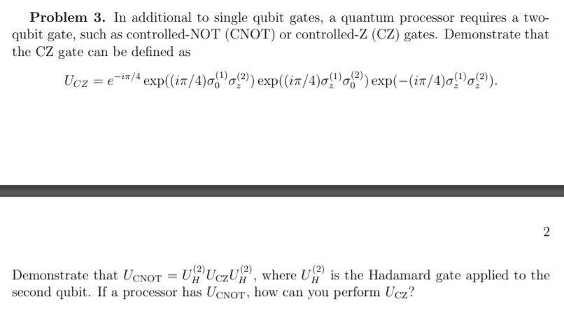

**see attached photo** sorry, it was impossible to format in a readable manner
sigma_0 is the identity matrix, and superscripts such as (1) and (2) indicates qubit 1 or 2 respectively
I have numerous points of confusion: what does it mean that the matrices are within the exponential? How do I go about doing the matrix multiplication to prove the given form of CZ matches the common form, the 4x4 matrix?
Update: using the fact that exp(At)=∑ ((t^n)/n!)*A^n, where A is a matrix. In this case I used three different A's for the three exponentials that form CZ, and found:
CZ= (exp(t))A'A ''A''', where A'=diag(exp(t),exp(-t),exp(t),exp(-t)), A''=diag(exp(t),exp(t),exp(-t),exp(-t)), and A'''=diag(exp(-t),exp(t),exp(t),exp(-t))
therefore, CZ=diag(1,1,1,-1) as expected.

Homework Statement:: **see attached photo** sorry, it was impossible to format in a readable manner
See Learn LaTeX for Math Equations.
This is indeed the correct approach.
