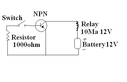

Can opening and closing switch turn on and off 10 ma relay
Not as drawn, but with a couple more resistors (or just a different configuration) and a diode, it can work. Have you tried using Google Images to find such circuits? Where did you get this one?
Likes CWatters
I think it's just misdrawn. NPN is supposed to be a PNP. I personally wouldn't do it that way but with the correct PNP it should work...
Ah, interesting thought! At least it will work once with the PNP (and no diode)... :wink:
Likes dlgoff
The relay coil is an inductor so it needs a parallel power diode to prevent the inductive reverse voltage spike that will otherwise destroy the transistor when the switch turns off and the magnetic field collapses.
