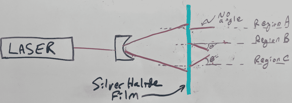

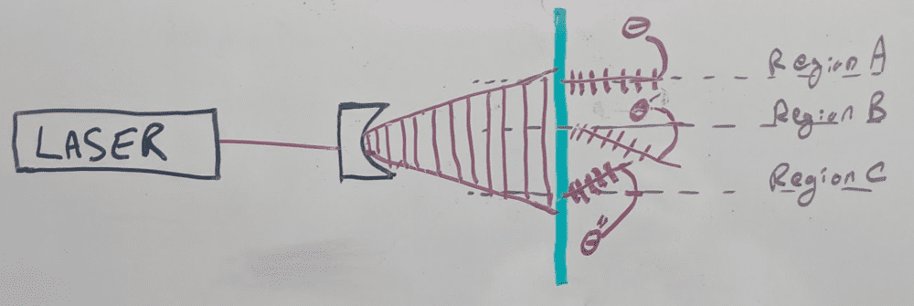

I'm a physics student, and working on a class project that requires coming up with a method to control
the exit angle (diffraction angle) of a monochromatic light source.
For example, taking a laser (monochromatic, coherent light source), spreading the beam, and directing the light at a piece of holographic film. Then, depending on how the original "hologram" or diffraction grating was recorded or encoded, determining the direction of the transmitted light. Basically, I'm trying to create a "holographic lens" of sorts.
Is this possible? and what resources would you recommend in figuring out how to expose or record the diffraction pattern?
Thanks for any info in advance!

I guess the question is, how could I make a diffractive optical element (DOE), and is it possible to do this with holographic film?

When you say 'control', do you mean variable control or just deflect by a given angle?
Your two diagrams seem to suggest that a diffraction grating could do the job. You can make a basic diffraction grating photographically using Young's slits (just one half of the pattern will have equal spaced maxima). You can work out the slit spacing for a given grating pitch and the slit spacing will need to be wider than for a normal Young's demo because the grating needs to be finer than you can easily see.
I don't know the present state of the art with home-made holography but I do know that the optics and the supports need to be held pretty steady and the film needs to be high res. (Those comments apply whatever your final solution is.)
PS the slits will need to be very narrow (as near omnidirectional patterns as possible) if you want the grating to have many maxima of 'equal' amplitude.
Likes Mike Gaffer
By _control_, I was looking at dividing an optical element, whether it be holographic film, or something else, into a grid; having each segment of the grid diffract a beam that is directed at it, at a unique output angle, and be able to calculate the output angle predictably. Then, be able to make this optical element so that I can have for example, square grid on the element (col 1, row 1) redirect light at 15 degrees, col 1, row 2 at 30degrees, col 2, row 1 at -10 degrees, etc... almost like a complex arrangement of little mirrors.

By "control" I mean, divide a piece of film into a grid of for example, 100 columns, and 100 rows, and have each square of the grid cause a beam impacting it to be "steered" at a different output angle... almost like a piece of engineered bumpy glass.
That sounds more and more like a diffraction grating. It seems that you don't envisage actually steering a beam (?). A diffraction grating will give beams at different angles at the same time, according to a simple rule. Your idea of using a hologram would be fairly straightforward. If you use multiple (split) beams of laser light - at the angles you will want, finally, they will interfere at the surface of your film and produce a hologram. This hologram will produce beams at the same angles when illuminated with a plane wave. It's actually a simpler thing to visualise (IMO) than what happens when a hologram is produced by shining laser light at a complicated object.
If you want to steer the beam, the methods suggested by @Andy Resnick are cool - but several stages in advance of the simple system you seem to be suggesting.
This idea is not the best because the hologram can occupy the whole of the film slide and each part of it will contribute to each output beam. That's how holograms work and the beams would be sharper because the 'aperture' would be wider and I think the beams would be brighter.
