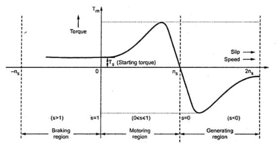

Would an induction generator with a regenerative FVD be a practical solution?
