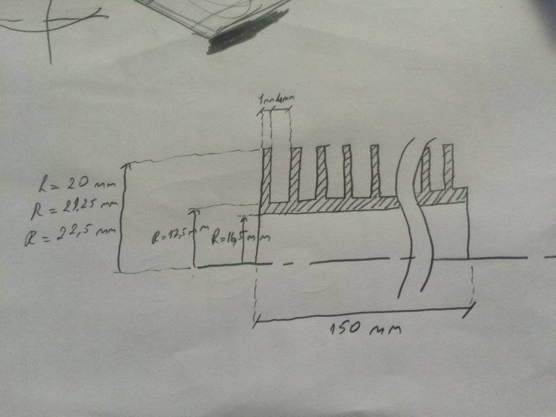

Hi. I am stuck on a project on calculation of heat convection transfer coefficient for a annular finned pipe.
All parameters [Diameter of pipe, diameter of fins for each case, the distance between fins, fin thickness, pipe length and fin number] are determined. And I have two book Fundamentals of Heat and Mass Transfer by Incropera/Dewitt and Heat and Mass Transfer by Çengel. I cannot determine how I will proceed. Should I refer to the conduction heat transfer for this project as well?
Would you like to give some guidance please?
Thank you.

Can you please provide a diagram. That would be very helpful. Apparently, a fluid is flowing through the annulus, but what is inside the inner pipe and what is happening outside the outer pipe? What is the flow rate and what is the fluid? What are the actual data?
. Inner and outer diameters of the pipe is 33 mm and 35 mm, respectively and inner temperature of the pipe is 60 Celcius. Thickness of the fins 1 mm, length of the pipe is 15 cm, the distance between fins 5 mm. So in every 5 mm there is one fin so there are 30 fins. These were constants. And now is the cases.
The temperature of air is optional as well.
1) Diameter of the fin 40mm, radius 20 mm
2) Diameter of the fin 42.5 mm, radius 21.25 mm
3) Diameter of the fin 45 mm, radius 22.5 mm
The velocity of the flow is optional, i.e I would like to choose the easiest and the most untedious one, the kind of fluid is optional as well.
Is everything O.K now?
P.S Eventhough I have studied convetion for two days, I am still for the situation of how I will derive the h, the convention coefficient.
Thank you.
My idea is first to calculate the heat conduction to calculate temperature of outer surface of the pipe, then assuming an environmental temperature I can calculate the film temperature surrounding the pipe. With this film temperature and knowing the environmental temperature I can calculate heat flux. But
1) With what equation, I can calculate the heat conduction and outer temperature of the pipe with specified number of fins?
2) With knowing, outer temperature and environmental temperature, I can calculate the film temperature, by those temperatures.
3) With what equation, I can calculate the convection heat transfer from the pipe with fins, knowing and using that film temperature and environmental temperature?
Thank you.

You have a single finned tube with air blowing over it, correct? If you knew the heat transfer coefficient on the air side, would you be able to determine the overall heat transfer coefficient for a single fin? What have you learned so far about heat transfer to finned tubes?

Yes, I have a single pipe/tube airblowing over it, but it has 30 fins on surrounding it.

The overall heat transfer coefficient U is based on the overall heat flow Q, the inside area of the pipe ##A=\pi D_iL##, and the total temperature driving force between the inside surface of the pipe and the air, namely 40 C: $$Q=UA(40)$$.
If you knew the temperature at the base of an annular fin and the heat transfer coefficient between the fin and the surrounding air ##h_a##, would you be able to determine the radial temperature profile within the fin and the rate of heat loss from the fin to the air?

The base of the fin is where it is attached to the pipe. Suppose you somehow knew the temperature at this location.

I think I should assume the base of the fin and inner surface of the pipe at the same temperature, i.e 60 celcius.
As I already know them, I still cannot determine the temperature profile within the fin and rate of heat loss from the fin to the air. I am not such skillful but I can conduct a study for them. Can I find them in the book of Çengel or in the book of Incropera/Dewitt? Or would like to give an instructive link for it? I have started to search it just now.

There is no need to assume anything right now. Just do it algebraically, and call the temperature ##T_b##.
I am not familiar with these books. Do you understand the heat conduction equation? Have you ever seen an analysis of cooling fin heat transfer? I have no idea what level of understanding your are starting from. Have you studied differential equations?

I understand heat conduction equation. It is a simple algebraic equation and I can apply boundary conditions to the differential equations. I can solve linear differential equations and separable differential equations.
I try to study analysis of cooling fin right now.
