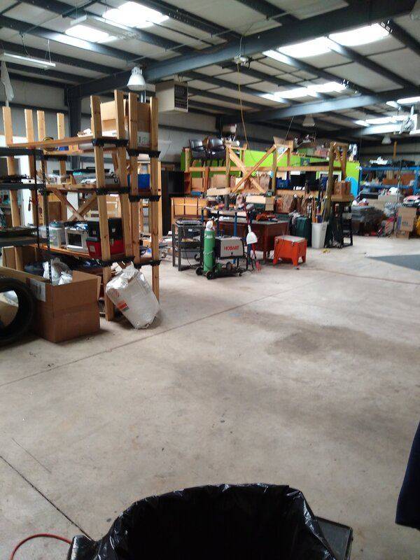

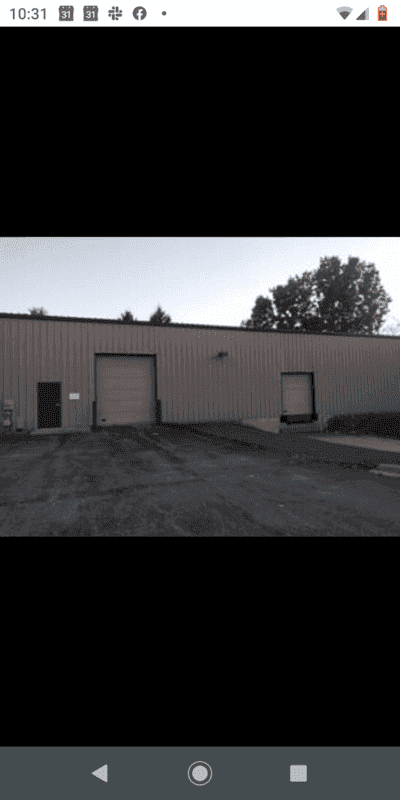

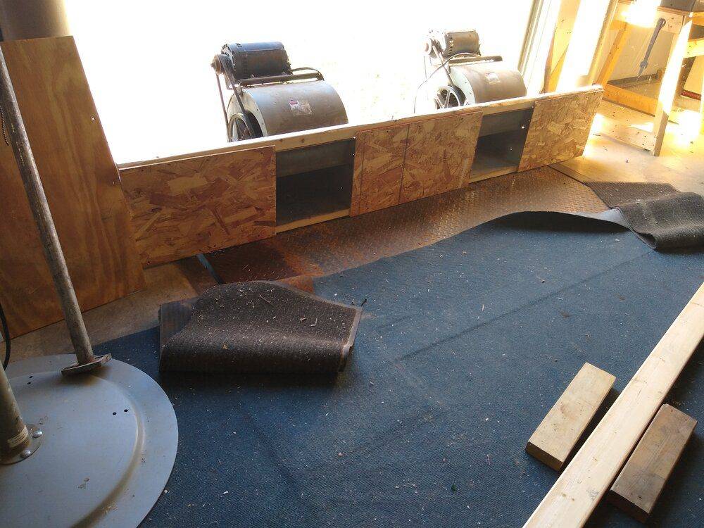

Ok things were going so well now I'm probably going to throw a monkey wrench in the works.
So I estimate that I'm moving 6000CFM into the building which has roughly 6000 sq. ft. and a 20 ft ceiling. I'm blowing air in at ground level and at lease some of it is leaving out the makeup air vents in the ceiling. As one would expect by the end of the day the temperature of the ceiling is higher than the walls and floor. I have observed that after I turn on the fans in the evening the temperature of the ceiling drops to the same temperature as the walls. So I think that I am pushing the hot air up and out when I pull in air near the ground.
The disappointing thing is that even after running the fans for 12 hours (something like 36 air exchanges) the indoor temperature is still 5 to 10 °F higher than the outdoor temp. For example if it gets down to 62°F at 4:00 AM, at 7:00 AM the indoor temperature is still 72°F.
I can't find any examples of night time ventilation for cooling of building where the exchange rate is changed. To see if I'm just moving too little air because of the huge mass of the building.

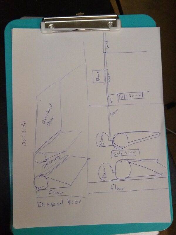

Here is the part that might kick up some dust, so to speak. The air coming out of my blowers is going 30m/s (60 mph) I would like to use the Coanda effect, entrainment and pressure drop of the Dyson Bladeless fan to increase the volume of air that I'm moving into the building from outside. It seems to me that with my transformer analogy I'm not violating and conversation laws if I move more air at lower speed. (I won't venture to guess if it is a velocity or velocity squared relationship.)
It seems that I don't need to restrict the air flow inorder to get higher velocity so I should not have the attention effect just the amplification effect. I'm thinking that I use to cylinderical cardboard concrete forms. Run them horizontally across the garage door. One on the ground and one some distance above. Then I make wedges out of four sheets of plywood. The top most and bottom most are horizontal. The inner two sheets provide the increase in cross section for the pressure decrease that Dyson claims.
If I can get a four fold increase in the volume of air it seem that should provide more exchanges and be able to bring the indoor temperature down closer to the night time outdoor temperature. It would make a huge difference to start the day at 62°F rather than 72°F.
Why don't people do this already? Dyson patent?
Attached is a very poor drawing with three views to maximize confusion.
As always thanks for reading and for any input.
This is 100% correct.
You are up against some laws of physics relating to natural convection:
1) Air flow by natural convection is proportional to the temperature difference.
2) Air flow by natural convection is proportional to the height difference.
3) Extending a roof vent upward increases the height difference. It also increases duct losses, so the increase in air flow will be less than you think.
4) To double the air flow through an existing system, you need to push four times as hard. That could be four times the temperature difference or four times the height.
5) To get double the air flow with the same height and temperature difference, you need twice the flow area.

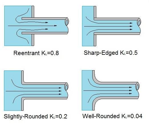

7) Sometimes you can get more air flow through an opening by rounding the entrance or adding a bell to the entrance. Search pipe entrance loss to learn more.

@jrmilcher thanks for the graphic that makes it very clear.
I have fans installed. Here is a picture of the box that holds them when it was half built. You can see the garage door track to the right of the right fan.
Here is a picture of the outside of the building.
The fans are in the door at the right. The truck well is rarely used. The larger door on the left could be opened several inches and a grid placed in the opening to prevent unwanted animals (including humans) coming in at night.
Here is the inside of the building.

5) I have plenty of velocity. 30 m/s (60 mph)What I propose.
A) I make a Dyson style duct that is rectangular out of cardboard concrete forms and plywood. The existing blowers will blow into the cylinder shaped forms which will be kind of like the rounded edge of an airplane wing.
B) Air will exit the cylinder by way of a slot going lengthwise in the cylinder. The cross sectional area of the slot can be as big or bigger than the blower exit.
C) The air will have to change direction so there will be a small reduction in efficiency from that.
D) The air exiting the slot will be directed along a piece of plywood and due to the Coanda effect to will stay close to the plywood.
F) Additional air will be entrained which will increase the volume of air moving but reduce the average velocity.
E) Their will be a second "wing" like a biplane but unlike a biplane the four surfaces of the wings will i arrange differently. The top of the top wing and the bottom of the bottom wing will be parallel. The two remaining surfaces will start closer together at the front where they attach to the cardboard cylinders and will become further apart at the rear until the meet up with the top and bottom surfaces. The cross section of the space between the wings increases from the front edge of the wing to the back edge.
F) Dyson claims that the increase in cross sectional area causes a drop in pressure which pulls even more air through the duct. (I believe this was demonstrated in Computational Fluid Dynamics (CFD) models.
If I'm right this should increase the volume of air that the fans move. Dyson claims 15x, CFD models of the Dyson Bladeless fan show about 7x if I remember correctly, the data sited earlier in the thread gave 6.22x. A multiplier of only 4x would increase the air exchanges from 3/he to 12!

Yes, because you earlier mentioned 6000 CFM and wanting to move about four times that much. Entrainment is always less efficient than directly moving the desired amount of air. Dyson uses entrainment for the purpose of hiding the blower, but as you have already seen, it is less efficient than a regular propeller fan.
The centrifugal blowers shown in your photo are designed to move air against a certain amount of back pressure, such as a duct system. They are not efficient for moving air through an open building.
The best way to move air through an open building such as yours is by one or more propeller fans such as these Aerovent panel fans: https://aerovent.com/wp-content/upl...RF-BPRV-DDP-DDPRC-DDPRF-DDPRV-Catalog-168.pdf. For example, their 48" fan, either belted or direct drive, will move about 20,000 CFM. One or two panel fans mounted similarly to your centrifugal blowers will move as much air as you want. A large fan running at slow speed will move as much air as a smaller fan running high speed. The larger fan will use less power, and will be much quieter.
Aerovent is not the only good manufacturer. I have also had good experience with New York Blower.

From the photos of the building interior, a major thermal mass is the concrete floor. If that is the case, attaining a high flow rate across the floor could help quite a bit. It would be informative to measure the floor temperature in early AM and at the end of day.

The concrete slab lags behind the temperature of the air by zero to 5°F. The temperature of the slab in front of the fans, which are at floor level is only one or two degrees colder than the air. I suspect that there is insulation under the slab because it does not seem to be cooler in the center of the building where the effect of colder ground should be bigger. It also does not seem to average out to a temperature lower than the air.
