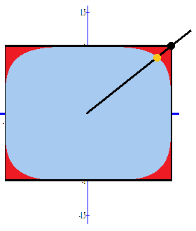

Next we draw an image. This restricts us on two dimensions and small ##n##, but it gives an idea.
For ##N=2## and ##n=4## we get:
where ##S-S_n## is the read area. Growing ##n## makes the blue "circle" more "quadratic". So it is sufficient to show that the maximal distance, between the yellow and the black dot, converges to zero. Or better, find a set description of such a red corner and show that its measure converges to zero.
Since the boundary equation of ##S_n##, namely ##\sum_{k=1}^{N}x_k^{2n}=1## is symmetric in it's variables and the same is true for the boundary equation for ##S##, namely ##|x_k |=1## for ##k=1,2,\ldots , N## the maximal distance will occur (assuming ##x_k\geq 0## for ##k=1,2,\ldots , N## because of symmetry) when all variables are equal, so let ##x=x_k## for ##k=1,2,\ldots , N##, then
$$\sum_{k=1}^{N}x_k^{2n}=1\Rightarrow \sum_{k=1}^{N}x^{2n}=Nx^{2n}=1\Rightarrow |x|=N^{-\frac{1}{2n}}$$
similarly on the boundary of ##S## we have ##(1,1,\ldots ,1)## as the indicated point so the square of the maximal distance then becomes
$$d^2(x)=\sum_{k=1}^N\left( 1- x\right) ^2 = \sum_{k=1}^N\left( 1- N^{-\frac{1}{2n}}\right) ^2 = N\left( 1- N^{-\frac{1}{2n}}\right) ^2$$
Hence ##d^2(x)\rightarrow 0+## as ##n\rightarrow\infty## and thus ##S_n\rightarrow S##.

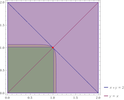

Edit: I need a break from writing this post, I'm going to post what I got now and edit later today... or one of you can prove the last two equalities please?
Here's a plot of ##\left\{x^{2*5}+y^{2*5}\leq 2,x^{2*25}+y^{2*25}\leq 2,x\geq 0, y\geq 0, x+y=2, y=x\right\}## the curved curve with a tighter corner is the curve ##x^{2*25}+y^{2*25}\leq 2## (yellow area)
so clearly we have ##S_{j+k}^N\subset S_{j}^N\, \, \forall j,k\geq 1## hence
$$S_{+}^N=\lim_{M\to\infty}\bigcap_{n=1}^{M}\bigcup_{j=n}^{M}\left\{ \vec x \in \mathbb{R}^N | 0\leq x_k \forall k,\sum_{k=1}^{N}x_{k}^{2j}\leq N\right\} $$
$$S_{+}^N=\lim_{M\to\infty}\bigcap_{n=1}^{M}\left\{ \vec x \in \mathbb{R}^N | 0\leq x_k \forall k,\sum_{k=1}^{N}x_{k}^{2n}\leq N\right\} $$
$$S_{+}^N=\left\{ \vec x \in \mathbb{R}^N | 0\leq x_k \forall k,\lim_{M\to\infty}\sum_{k=1}^{N}x_{k}^{2M}\leq N\right\} $$
$$= \left\{ \vec x \in\mathbb{R}^N | 0 \leq x_{k} \leq 1 \forall k \right\}$$

For my results to hold I require that I can use this sequence in Theorem 2:
$$S_{n}:=\left\{\vec x \in\mathbb{R}^N | x_{k}\geq 0\forall k\, , \sum_{k=1}^{N}x_{k}^{2n}\leq N\right\}$$
$$S :=\bigcap_{k=1}^\infty S_k = \left\{ \vec x \in\mathbb{R}^N | 0 \leq x_{k} \leq 1 \forall k \right\}$$
I'm not sure of how to prove via inequalities that
$$S\subset\cdots\subset S_{n+1}\subset S_n\subset\cdots\subset S_2\subset S_1$$
because in practice I used ##N=2## and lots of graphs to demonstrate the above property of ##S_{n+1}\subset S_n\, \forall n\in\mathbb{Z}^+##, any help would be appreciated. Thanks for your time!
