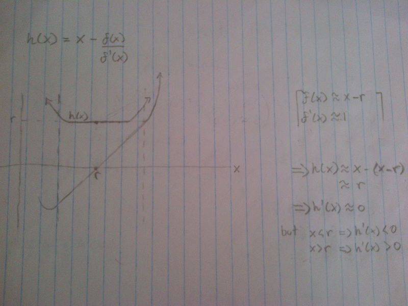

I read your post, and I will admit, I was a bit confused too. I needed to refresh myself on properties of contraction mappings on the real line and what not. I think the main reason you're having trouble is that you're forgetting what the function h actually is...
Let's abandon this [itex] x_n [/itex] business for a while. We have
[tex] h(x)=x-\frac{f(x)}{f'(x)}. [/tex]
So what do we know about h? Well, first off, our root r is a fixed point. Indeed, h(r)=r-f(r)/f'(r), but since r is a root of f, f(r)=0, so h(r)=r. What about the derivative of h at r? We have
[tex]
h'(x)=\frac{f(x)f''(x)}{f'(x)^2},[/tex]
so h'(r)=0.
What does h look like in a small region about x=r? Let's pick an easy example for f (this isn't a big deal, since given your assumptions on f and its derivatives, you can always derive similar estimates to the ones I'm about to). Suppose in a sufficiently small open ball around r, we can approximate f by a linear function: f~x-r. So its derivative f'~1, and f''~0 in this same small ball. Hence, in this small ball, h~x-(x-r)/1, therefore h~r, and h'~0. See the image below; the vertical bars denote this open interval (in reality, this interval would likely be much smaller, but I've drawn it larger so we can actually see it).
In particular, in a sufficiently small open ball around r, we have [itex] |h'(x)|<1 [/itex]. Denote this ball by D. Knowing this, what can you say about the behaviour of h in D? What happens to the sequence [itex] x_{n+1}=f(x_n) [/itex] if [itex]x_0\in D[/itex]?
EDIT: I drew f wrong (it's derivative is negative to the left of the interval), and forgot to label it, but that's ok.
As for why there's this confusion over the derivative of h being negative to the left of the root, and positive to the right of the root, I would discuss this by analogy with ordinary differential equations (I'm going to assume you've taken an elementary course in ODEs)
In ODEs, if you have a 1-dimensional homogeneous ODE x'=f(x), then you would think of the function f as telling you which direction your point x is going to move. For example, if f(r)>0, then a point sitting at x=r will move to the right (ie. positive). If f(r)<0, then such a point will move to the left (ie. negative). If f(r)=0, then a point starting at x=r doesn't move; r is a fixed point, or equilibrium.
You might recall that to determine the stability of an equilibrium r, you take the derivative of f, and evaluate at r. If f'(r)>0, then it's unstable, and if f'(r)<0, then it's stable. Suppose it's stable, then f'(r)<0. If f' is continuous (which it should be, as this is often a requirement for standard ODE theorems to be applied), then there's an open ball around r, call it B, such that if x is in B, then f'(x)<0. But this doesn't mean that points to the left of r will necessarily move away from the equilibrium... f' at points near the equilibrium say NOTHING about its stability: only f'(r) matters.
This is similar to discrete processes (eg. Newton's Method), except that the stability criterion is that we have to have |f'(r)|<1. See the proof of the banach fixed point theorem if you want to know why this is.
So in the end, there are is one big thing to remember to avoid confusion...
1) f'(x) doesn't tell you where x is going to move. f'(r) at a fixed point r determines it's stability (equivalently, Lipschitz constant in a sufficiently small neighbourhood of r).

Also, what you have written here is
x>r => h(x)<x
x<r => x<h(x)
However, this does not imply that h is increasing or decreasing. We know that h'(x)<0 for x<r, and h'(x)>0 for x>r. See the image below: this is not a contradiction.
These questions are really helpful for me, since in about two weeks I'm going to be TA-ing a first-year calculus course which has a section on discrete systems, as well as Newton's Method. This is good review :)
Thank you so much.
I guess i was confused with the output of h(x) being also the input (points in the x axis) for f.
Your illustrations have cleared things out a bit :)
