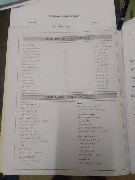

Queries regarding MKS to CGS system for the following formulas.
Force - Newton (MKS), Dynes (CGS)
Work - Joule (MKS), Ergs (CGS)
1N = 10^5 dynes.
1J = 10^7 ergs.
How the above unit conversion formulas are derived ?
Look at the dimensions of force and energy.
force = M L T−2
energy = M L2 T−2
Convert CGS cm to MKSA metres.
Convert CGS gram to MKSA kg.
