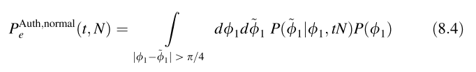

The equation to calculate the error probability of PNS attack is given by:
Where the region condition satisfied:

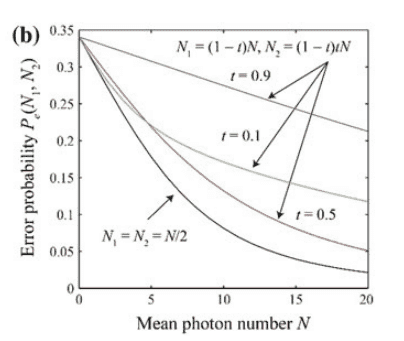

The error probability of PNS attack should be plotted like this:

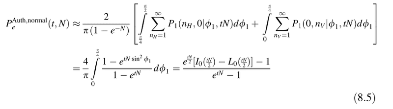

My question: How to insert equation 8.1 into equation 8.5?
This is my python code according to equation 8.5:
Python:

When x=0 then N=0 hence the denominator is zero and so you are dividing zero according to the equation.
In your code, you misplaced the last paren. it should look like this:
Python:
y = (   np.exp(x*t/2) * (iv(0,x*t/2) - modstruve(0,x*t/2)) - 1   )  /  (np.exp(x*t/2) - 1)
This code now gives a runtime divide error at zero but the curve looks more like what you want.
Thank you so much. Finally I did plot the graph.
