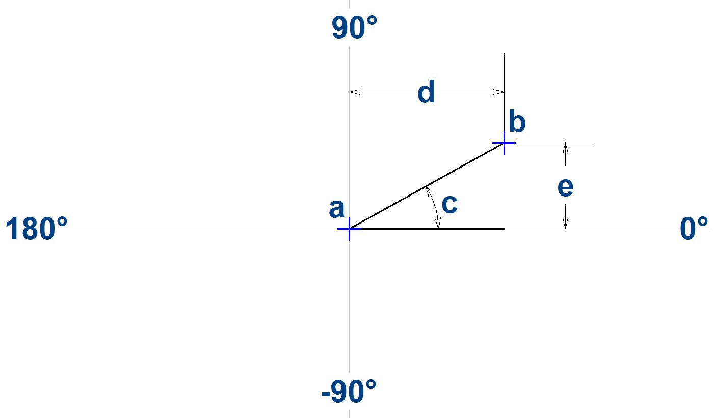

I'm looking for a little help here. I'm just a relatively regular Joe here though, so any complicated formulas are likely to go right over my head. What I'm trying to do is use the Ruby programming language to convert rise and run (slope) to degrees. See the attached screenshot...
Assume x and y-axis are constant and that point a is always at 0,0. I want to use dimension d and e to obtain an angle in degrees. In this example:
d = 334.385384
e = 187.413131

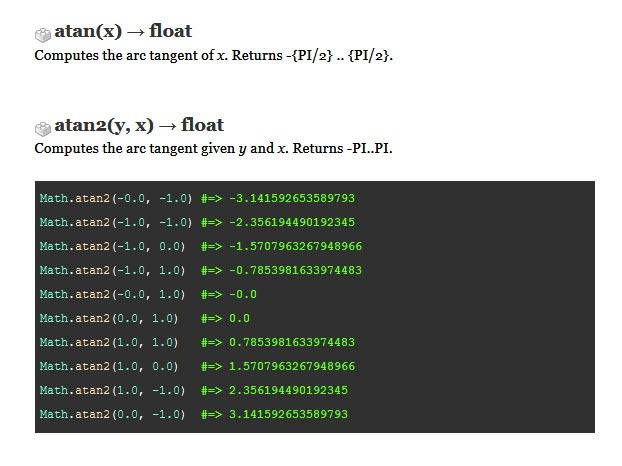

I happen to know that angle c = approx. e° due to some tools I have available in my CAD program, but I really want to be able to plug d and e into a formula so I can get some automated feedback using some Ruby scripting. Ruby has an Arc Tangent function...
...but I'm really not sure how to use it. I tried using atan(e/d) but that results in 0.5108463979434283
I'd love if someone could help me understand what I'm doing wrong. Thanks.

Hi Alaskan Son,
I presume your problem is that you want the angle in degrees?
You are getting the result in so called radians.
To get degrees you need to multiply by [m]180 / Math::PI[/m].
So for instance [m]atan2(1,1) * 180 / Math::PI[/m] = 45.

Thanks you, but I purposely labeled them like that. Those are the way angles are used in my drafting program and my goal is to have angles that report in those exact formats. Now that I have the proper formula, I think I can make it work.
Actually, upon further investigation, the following formula results in exactly what I was looking for...
(Math.atan2(y_position,x_position)*180)/Math::PI
Thanks again guys.
