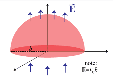

A hemispherical surface of radius b = 61 m is fixed in a uniform electric field of magnitude E0 = 3 V/m as shown in the figure. The x-axis points out of the screen.
Enter the general expression for an infinitesimal area element dA in spherical coordinates (r, θ, φ) using n as your outward-pointing normal vector. In these coordinates θ is the polar angle (from the z-axis) and φ is the azimuthal angle (from the x-axis in the x-y plane).
φ(flux) = ∫ E dA
I understand that we're supposed to be looking for a small piece of area, but I don't know what makes up that area. We had a triple integral last semester of ∫∫∫r2dr sin(θ)dθ dφ. Is that related? We used that to integrate the volume of a sphere. Is there a similar process one can use for area?
I guess you can either look up the area element in spherical coordinates or work it out for yourself from first principles.
Very much so. Suppose you had an area element dA for a shell radius r within the sphere. How would you turn it into a volume element? Compare that with the integrand above.
