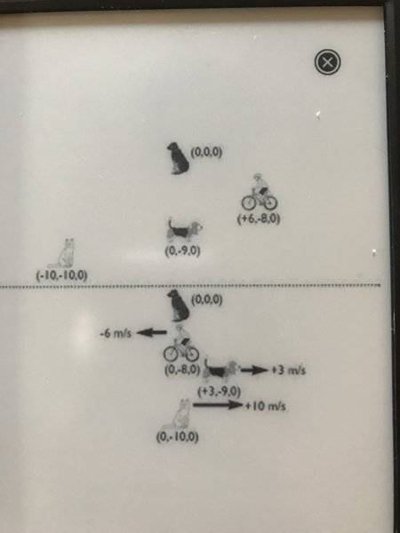

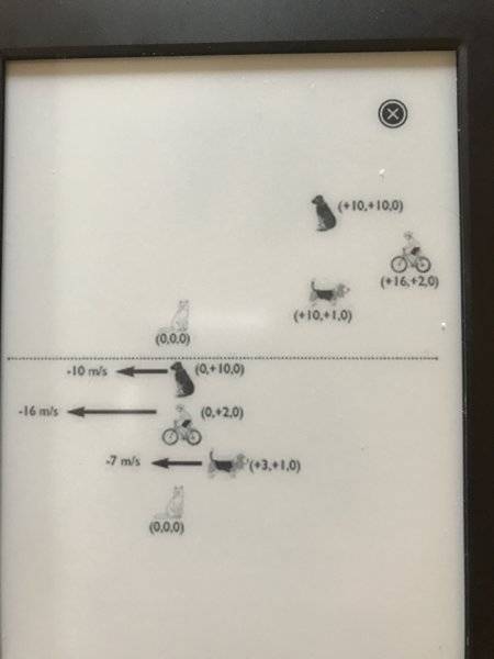

There are a couple of diagrams (hopefully attached) but they involve more frames of reference. The diagrams also introduce a child riding a bike and another dog.

Let me tell you how I did it. First, we've got some coordinates at ##t =0##, always useful. I'll give Emmy's first:
##t=0##: ##(0, -10, 0)## and ##(0, +10, 0)##
So, where is Nero in Emmy's frame? What about ##(0, -20, 0)##? That makes sense. ##+10## for him is ##-10## for Emmy.
Now, at ##t=1##, always better for ##t## to be increasing:
##t = 1##: ##(10, -10, 0)## and ##(-10, +10, 0)##
Where is Nero now? What about ##(20, -20, 0)##? That looks right. Add on his coordinates and you get Emmy's.
So, Nero's velocity (in Emmy's frame) is ##(20, 0, 0)##.
Hmm, so isn't the rule really that:
Emmy's coordinates for an event = Nero's position in Emmy's frame + Nero's coordinates for the event?
Isn't that quite simple?
And, Nero's position is: Nero's starting position + (Nero's velocity x time).
That's the way I'd think about it anyway.
