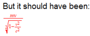

Hi,
I was trying to derive relativistic momentum equation using classical momentum equation but it didn't work. Could you please help me? Thank you!
Where am I wrong? Or, is not possible, in any way, to derive relativistic momentum using Newtonian momentum equation? Thanks!

You are using the wrong approach to go from Newtonian to relativistic momentum. There are several ways to do it correctly. One is to solve for a function of m and v that, if conserved in one frame, is necessarily conserved in another frame, via Lorentz transform. You would pick some generic collision to do this.
A more direct way is to use 4 vectors. An equation of 4 vectors that holds in one frame necessarily holds in all. There is 4 vector corresponding to velocity, called 4-velocity. Assuming mass is a scalar quantity, then if momentum defined as mass times 4 velocity is conserved in one frame, it is necessarily conserved in all.
Your method makes an erroneous assumption about what feature of Newtonian momentum you should try to preserve. The key things to preserve are that the momentum of two bricks that move at the same speed is twice that of one brick, that faster means more momentum, and that conservation of momentum holds in all frames.

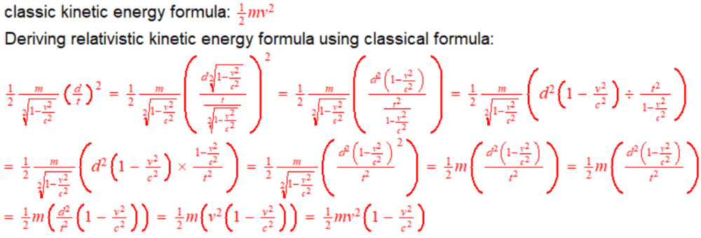

Thank you!
Does the same reasoning go for the case when relativistic kinetic energy is derived from classical kinetic energy?
Actually I tried to do it as shown below but, as is obvious, got the wrong result.
The Newtonian formulae are approximations to the relativistic ones. You can't deduce accurate expressions from approximations any more than you can deduce my exact age from a statement that I'm in my forties.
The best you can do is note that relativistic equations are based on four vectors and tensors and guess a four vector generalisation of a Newtonian expression, as @PAllen suggests.
Incidentally, even if the whole approach weren't mistaken, your algebra's wrong in your last calculation. Correct algebra would yield ##\frac 12mv^2\left(1-\frac{v^2}{c^2}\right)^{3/2}##. Also you are using ##d## and ##t## for both the coordinate and proper lengths and times, which is just confusing.

The irony is that the first thing you have to do is to abandon the idea of a relativistic mass and just use the definition of the momentum as in Newtonian physics to get to the right relativistic momentum. The important point is that you have to use the proper time, i.e., the time a clock measures moving with the particle. That's also true in Newtonian mechanics, only that there time is absolute and there is no difference in the universal, absolute coordinate time and proper time.
In relativistic theory the connection between proper-time increments and coordinate-time increments (in coordinates with respect to an inertial reference frame) is
$$\mathrm{d} \tau=\mathrm{d} t \sqrt{1-\vec{v}^2/c^2}.$$
Whith this you get the correct relativistic momentum as
$$\vec{p}=m \mathrm{d}_{\tau} \vec{x} = m (\mathrm{d} t/\mathrm{d} \tau) \mathrm{d}_t \vec{x} = m \gamma \vec{v},$$
where ##\gamma=1/\sqrt{1-\vec{v}^2/c^2}## is the famous Lorentz factor and ##m## is the invariant mass, related to the energy of the particle in its rest frame ##E_0=m c^2##, which is a Lorentz scalar.
It's also immediately clear that the corresponding four-vector is
$$p^{\mu}=m \mathrm{d}_{\tau} x^{\mu} = m \gamma \begin{pmatrix}c \\ \vec{v} \end{pmatrix},$$
and the temporal component turns out to be the relativistic energy of the particle, including the rest energy ##E_0##, i.e.,
$$E=c p^0=E_0 + E_{\text{kin}} = m c^2 \gamma.$$
For ##|\vec{v}/c| \ll 1##, i.e., in Newtonian physics
$$\gamma \simeq 1+\vec{v}^2/(c^2)$$
and thus
$$E \simeq m c^2 + \frac{m}{2} \vec{v}^2 \; \Rightarrow \; E_{\text{kin}} \simeq \frac{m}{2} \vec{v}^2,$$
as it should be in the Newtonian approximation.
