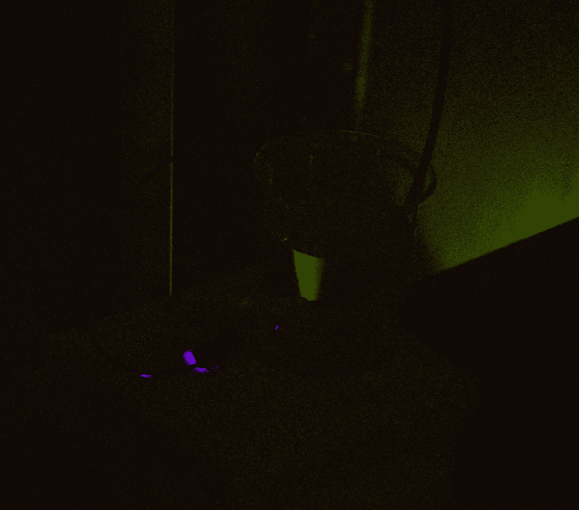

Here's a picture of corona on a connector. You can ignore the green. I have a PD checker on the floor with a tiny green LED that I didn't notice until I looked at the picture. Hey I guess it helped to illuminate the room just enough to make out what I have though...by the way, I have my HV lead connected to the wire and connector I'm testing. Their connection is in oil which is what's in the beaker. The purple on the glass is reflection from the oil.

yes, I agree, that camera body is too nice to screw-up.
