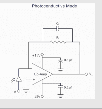

What bandwidth do you want to achieve? Optical diode detectors are not usually operated at zero bias; reverse bias improves bandwidth and gives you a better detector signal. Often done like this:
https://www.allaboutcircuits.com/te...hotoconductive-modes-of-photodiode-operation/
Ah I actually don't know much about this. What do you mean by bandwidth in this case? It is the frequency with which the peaks appear? Also how do I achieve reverse bias in practice (the diode has only one BNC output)?

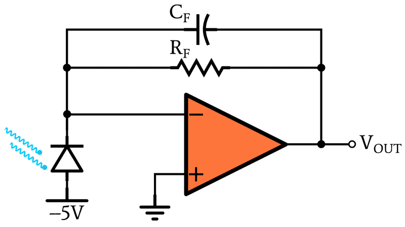

How accurate do you need to be? If you really want accuracy I would choose photoconductive mode rtaher than photovoltaic
What you have done should get you within a factor of 2 for sure. Be aware that the slope on the silicon photodiode spectral response falls off pretty fast above 900nm (you are at 45% at 1064 ) and that is Temp dependent.
If you are not rapidlly passing through the peak signal (>kHz) then the bandwidth should not matter.
