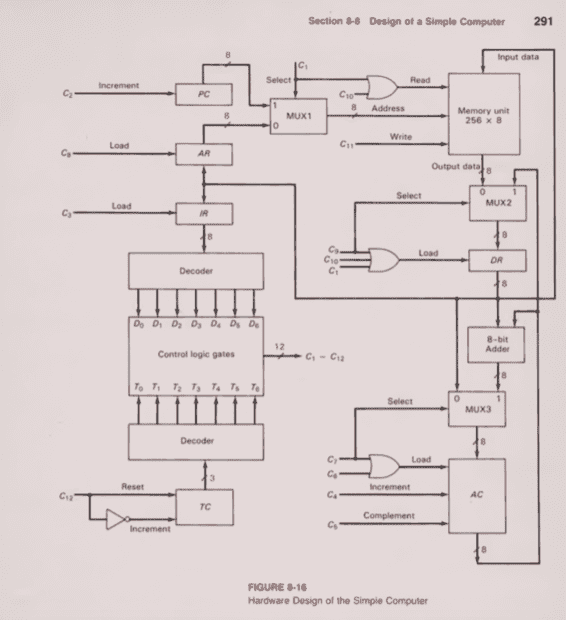

My query is about muti-level circuits that contain different ICs and other components interconnected together by a system bus. for eg: computer motherboard.
Let us take this example to make my point clear.
fig: final architecture
Above is the FINAL computer architecture which I see in probably every other book.

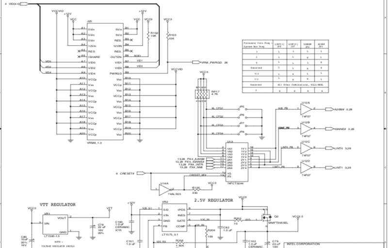

All I want is to implement hardware out of it i.e I want to implement it into a TECHNOLOGY SCHEMATIC.
So what should be my first step??
or you can say that I want to MAP this architecture into TECHNOLOGY HARDWARE.
The sooner I get the technology schematic (bottom figure), I can simulate it into a circuit simulator for eg Altium designer etc.
So the real deal for me is to bridge the gap between this final architecture and its schematic.
fig: schematic (just an e.g- something like this)

OK, then I think you'll need to choose a component for each functional block. Then read all of the data sheets to find the details about each signal (something like this). Choose a family of signals and stick with it as much as possible, for example don't try to mix LSTTL and HC logic signals. You'll need to verify that each signal has outputs are compatible with the inputs they are connected to. For example, can a clock driver source enough current for the many inputs it has to drive, etc.
Some functions in your block diagram may no longer be commonly available (things like ALUs etc.) because in the real world they're always integrated as part of a more complex part, like a uP.
It's all about the details of each of the components at that level.
PS: It is also very common for designers now to just replace lots of these basic functions with programmable logic, something like an FPGA or CPLD. This puts you back into the "code is everything" mode.
Likes brainbaby

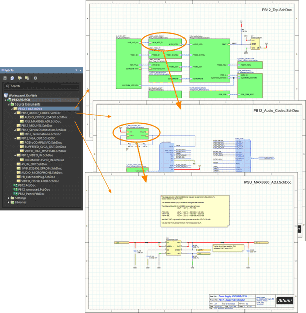

So you're meaning something like this? (Courtesy of Altium)
Likes brainbaby and DaveE
Somewhat yes. Though the image is bit blurry, it seems that the top fig is a block design that seems to be converted into a much simpler abstraction (not sure)
or we can say that it's an eg of project hierarchy where each schematic document is linked back to the top sheet.
Well the above is somewhere near to my expectations but this I think is an example of encapsulation (i.e wrapping up of data into a single unit (just like blocks here))
This is NOT synthesis
I want synthesis i.e breaking a larger hierarchy into a much simpler one with the use of CAD tools or manually but for a smaller design, as I've iterated earlier.
