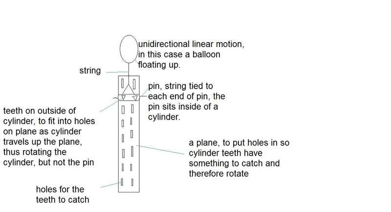

First of all I would like to apologize for the crudeness of the picture, don't have many tools to work with or time at the moment so it is the best I could do. Of course this is just to illustrate the basic concept of what I am trying to get and there would be numerous flaws with this design, the most obvious being that the device will no longer function once it reaches the top of the plane, but again this is just in the hopes of more clearly explaining what it is that I have in mind. With that being said, would the basic idea here be plausible, and, if so, any suggestions on a way to reset the cylinder to its starting position once it reaches the top of the plane? Such as having the plane itself rotate 180 degrees with the cylinder at the top, essentially putting it back at the bottom? Of course I know that wouldn't work with the example I drew. And yes, I did make it in paint. I'm not Picasso.
Edit: I'd also like to thank rcgldr, as the post made above is what helped me think of this.
This is also where my skepticism comes into play.
If the plane were to rotate, would I be correct in assuming it would need
to overcome the force of the balloon pulling it up before rotating?
You could have a screw thread inside of the cylinder, so as the balloon rose it dragged something up the thread causing the cylinder to rotate. There's a bit more to it, but that's the idea.
It will take more energy to return the balloon to the ground than you can extract through it rising.
Unless you are prepared to wait until night time? I'm thinking it may be possible to arrange for the air in the balloon to cool faster than does the air at ground level, this causing the balloon to gradually descend of its own accord.
