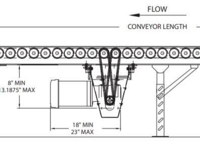

Every hex shaft conveyor roller I have ever seen, or even heard of, has bearings. The shaft drops into slots in the conveyor frame, and the roller spins on the bearings. The rollers can be driven by a belt from a reducer that is wrapped around the roller:

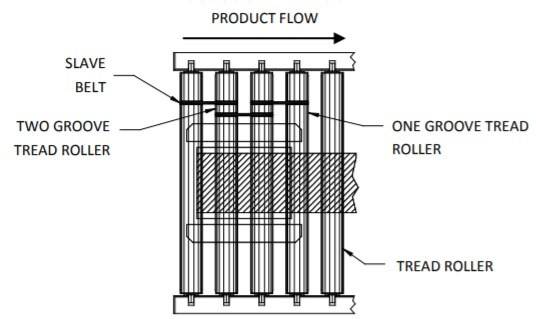

They can be driven by an adjacent roller:
There is a third way to drive the rollers, but I did not find a good drawing of it. You can search roller conveyor drive for more information.

As @jrmichler suggests, the hex shafts are probably idler rollers that contain free running bearings.
Those internal bearings, pressed into the ends of each idler, may be “hex bore” conveyor bearings.
