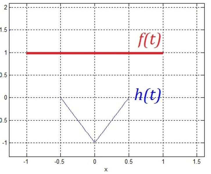

Compute the convolution ##(f*h)(t)## where
$$f(t) = \left\{\begin{matrix}1, \ \ for \ \ |t|<1 \\ 0, \ \ \ \ otherwise \end{matrix}\right.$$
and
$$h(t) = \left\{\begin{matrix}2|t|-1, \ \ for \ \ |t|<1/2 \\ 0, \ \ \ \ otherwise \end{matrix}\right.$$
Convolution integral: ##(f*h)(t)= \int^\infty_{-\infty} f(\tau) h(t-\tau) d \tau##
[/B]
Here I first made a sketch of the two functions:
f(t) is non-zero on [-1, 1] and g(t) is non-zero on [-0.5, 0.5], so adding these two we find that (f ∗ g)(t) should be nonzero on [-1.5, 1.5]. The list of change points of (f ∗ g)(t) is {-1.5, -0.5, 0.5, 1.5}. For values t that are outside this range the convolution is zero.
So, do I need to calculate the convolution for 3 separate cases?
I mean ##-1.5 \leq t \leq -0.5##, ##-0.5 \leq t \leq 0.5##, and ##0.5 \leq t \leq 1.5##?
Here is my attempt:
First case: we want to integrate from -1.5 to -0.5 using the formula given above (##(f*g)(t)=\int^{0.5}_{-1.5} f(\tau) h(t-\tau) d \tau##). ##h(t)## is zero. But for ##f(t)## the function is zero on the interval ##(-1.5, -1)##, whereas it is equal to 1 from ##(-1, -0.5)##, so what value do I need to be using for the function? :confused:
Any help is greatly appreciated.

If ##f## is zero on an interval, the integral simply vanishes there. Then you get:
##(f*h)(t)=\displaystyle \int^{+ \infty}_{-\infty} f(\tau) h(t-\tau) d \tau = \int^{1}_{-1} h(t-\tau) d \tau##.
(EDIT: I had written ##(f*g)(t)## instead of ##(f*h)(t)##, typo now corrected.)

Thank you Samy for your response.
For the case ##-1.5 \leq t \leq -0.5##, could you please explain how you got the integral limits to be ##(-1,1)## instead of ##(-1.5, -0.5)##?
I think alternatively it is also possible to rewrite the integral limits like:
$$t+0.5 \leq \tau \leq t+1.5$$
In the interval ##[-1.5, -0.5]##, ##x+0.5## is between -1 and 0. Whereas ##x+1.5## is between 0 and 1. So the integral can be rewritten:
$$(f*h)(t)=\int^{t+1.5}_{t+0.5} h(t- \tau) \ d \tau$$
I am not sure how to proceed from here. How exactly does a substitution help? (this is my first convolution problem of this type)

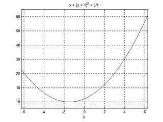

Thank you for the explanation. Yes ##h## is ##-2t-1## for negative σ. So, for instance for the case ##-1.5 \leq t \leq -1## this is what I found:
$$(f*h)(t) = -\int^{t+1}_{-0.5} h(\sigma) d \sigma = -\int^{t+1}_{-0.5} (-2t-1) \ dt = - \left( (t+1)^2 -(t+1)-0.25 \right)$$
Is this correct?
This function looks like an inverted parabola. This is the region of interest:
I just want to make sure it is done correctly so I can calculate the other integrals, and sketch ##(f*h)(t)## to make sure it is an even symmetric function.

Oops, I did the integral again and there was a sign error as you suggested:
$$- \int^{t+1}_{-0.5} (-2t-1).dt = -\Bigg[ \frac{-2 t^2}{2} -t \Bigg]^{t+1}_{-0.5}$$
$$= - \left( \Big[ -(t+1)^2 - (t+1) \Big] - \Big[ -(-0.5)^2 - (-0.5) \Big] \right) = (t+1)^2 + (t+1) + 0.25$$
This time it's a right way up parabola:
Is that what you have also?

Yes, I have the same result. ##(f*h)(t)=t²+3t+\frac{9}{4}## for ##t \in [-1.5, -1]##.
Notice that now the value in -1.5 is 0. The value of the first derivative in -1.5 is also 0. That is as expected, as ##f*h## is 0 below -1.5, and is a differentiable function.
Likes roam

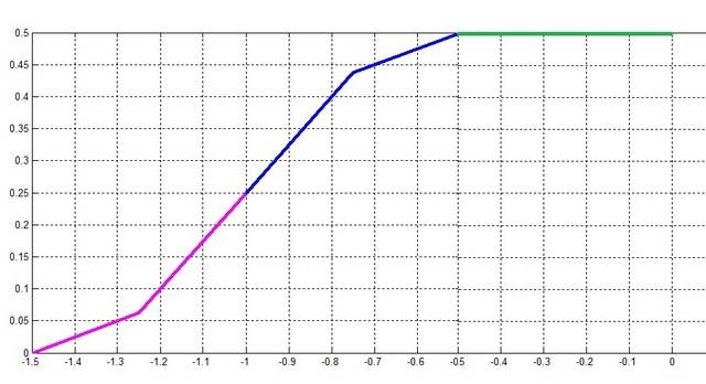

Thank you so much for the explanation.
For case (c) I found:
$$(f*h)(t)= - \Big[ \int^0_{-0.5} f(t) h(\sigma) d \sigma + \int^{t+1}_{0} f(t) h(\sigma) d \sigma \Big] =- \Big[ \int^0_{-0.5} (-2t-1) d t + \int^{t+1}_{0} (2t-1) d t \Big]$$
$$= -(t+1)^2 + (t+1) + 0.25 = -t^2-t+\frac{1}{4}$$
This function is the inverted version of y=x2+3x+(9/4) we found for part (b).
For case (d) I found:
$$(f*h)(t)= - 2 \int^{0.5}_0 (2t-1)(f(t)=1) dt = 0.5$$
The graph in Matlab looks like this so far for ##t \leq 0## (parts (b), (c), and (d) are shown in magenta, blue and green respectively):
Since the ##(f ∗ h)(t)## is continuous and even I think the other half (in blue) should look like this:
Is this correct?
Yes, I found the same results for cases c) and d).
As ##f*h## is even, you indeed can just take the mirror image of the graph for positive ##t##.
To be clear, from ##-1.5 \to -0.5## the graph segments are parabolic, not straight lines (and likewise on the positive side).
Likes roam
I get it now. Thank you so much for your time and help.
