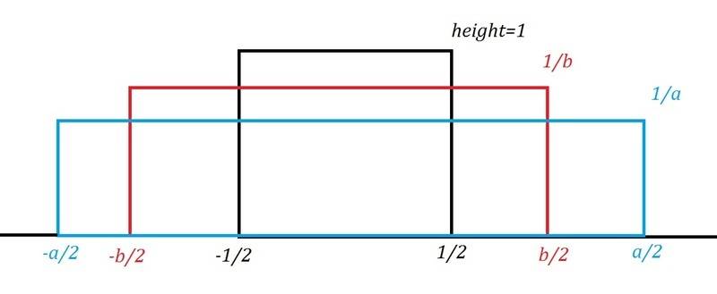

I tried to graph each ##\Pi##. The factors of 1/a and 1/b in the argument of each ##\Pi## tell us that they are stretched by a and b respectively. And the heights are also altered by the factor in front of each function. If we superimpose the two pulses it would look something like this (compared to the original unscaled ##\Pi##):
So, how exactly does this help me find the expression for the multiplication in equation (1)?

That part is simple. To make it easier, have both rectangles be height 1. In any case, how much is "0" times "0" ? , how much is "0" times "1"? How much is "1" times "1"? You are missing the obvious. The shape of the product of the two functions is the narrower of the two functions.
By narrower of the two functions do you mean ##a-b## (i.e. ##\frac{1}{|a.b|} \Pi \left( \frac{-\nu}{a-b} \right)##)?
No. Simply ## (1/|ab|)\Pi(-\nu/b) ## for b<a.
