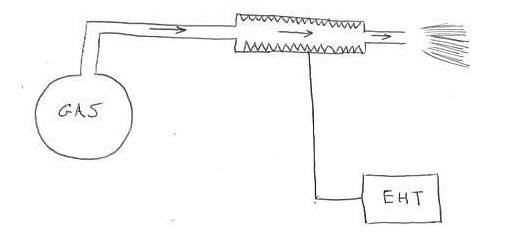

I was thinking of its application to cool a jet of gas. Here is a quick sketch. Pressurised gas flows through a nozzle which has sharp points attached to a EHT. The electrons are ripped from the gas thus ionising it as it passes over the grid. Will the temperature of the gas be reduced?

usually when a plasma is created it gets hotter.
A plasma would be created if you used a massive amount of electrical energy, considering the fact that we are dealing with gas at pressure. I however was just thinking about the production of ionised gas as opposed to a plasma state.

How are you planning to "rip" an electron away from a nucleus without giving the nucleus a BOOST in kinetic energy (and thus temperature)?
