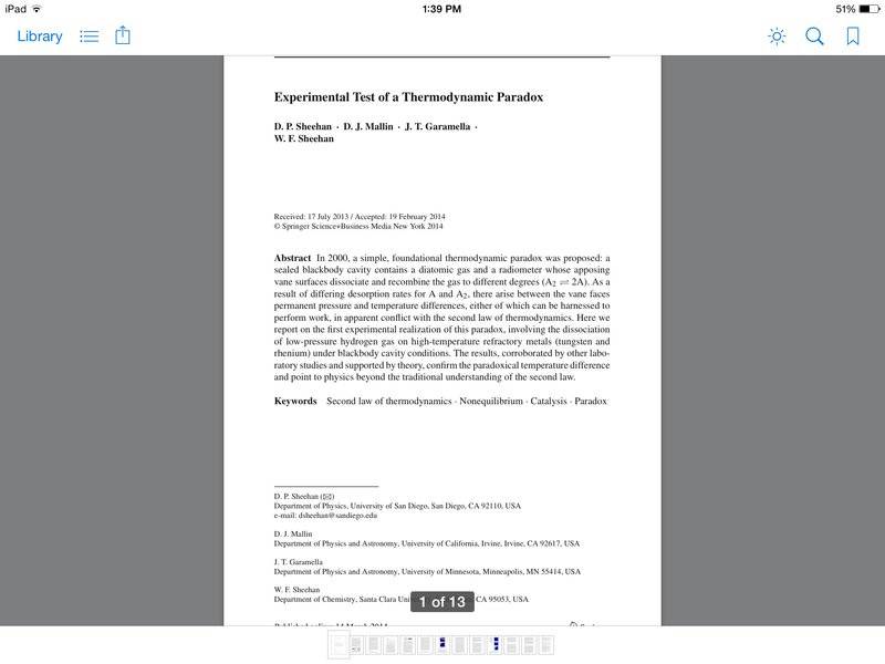

This paper may relate to the question at hand. It refers to a different but I think equivalent situation. Here is the reference;
Found Phys
DOI 10.1007/s10701-014-9781-5
