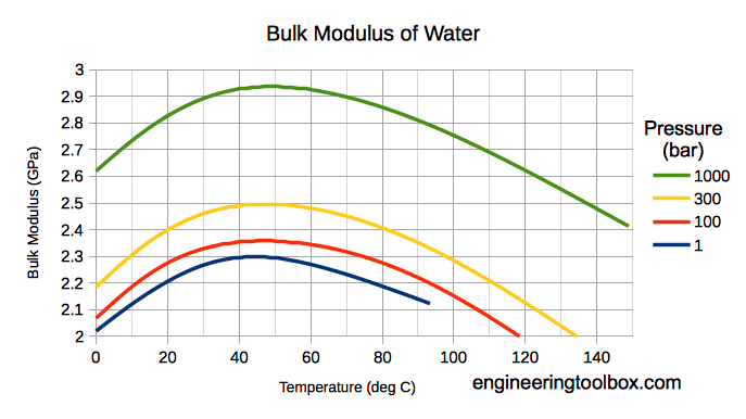

If the tank is ideally inflexible (a decent approximation for a very strong, very thick tank) then we still have to worry about the water. Real water is compressible.
If you chill the water (toward about 4 degrees Celsius) it will tend to shrink away from the container walls. However, this will relieve the atmospheric pressure to which it had been subject. It will expand as a result.
What is the bulk modulus of water? We can ask Google... 300,000 PSI. Imperial units. Bah. We can ask again and get the answer as ##2 \times 10^{9} \text{ Pa}##. Even more useful for our purposes would be the same figure expressed in atmospheres. Call it 20,000 atmospheres.
This says that if we reduce the volume by a small fraction (e.g. one percent) then we will get a pressure increase of that same percentage of the bulk modulus. So one percent volume decrease is going to result in a pressure increase by 200 atmospheres. The reverse is also valid. One percent volume increase = 200 atmospheres of pressure decrease.
Or we can turn it around the other way. One atmosphere of pressure reduction is 0.5 0.005 percent of volumetric expansion. Edit: Note factor of 100 error here
How much temperature reduction do we need to get 0.5 0.005 percent of volumetric reduction? The formula for water is nasty. But we can Google up some figures.

If water density, ρ=m/V at 1 atm is:
992.25 kg/m3 @ 40'C
998.19 kg/m3 @ 20'C
But neither mass nor volume may change.
The Bulk modulus B, may be used to determine the change in pressure, but it varies with bulk stress ##\sigma _b##, and is the inverse of compressibility =~ 3.3 × 10^6 (psi)
But one needs to estimate the pressure in order to determine the Bulk modulus and here the pressure is a huge on the liquid.

Huge pressure? For a liquid at atmospheric pressure cooling within a container of fixed volume, the pressure would likely be somewhere between 0 and 1 atm absolute.
Surprisingly large negative pressures are possible for pure degassed water. However, tap water in containers of ordinary cleanliness will cavitate/boil readily.
