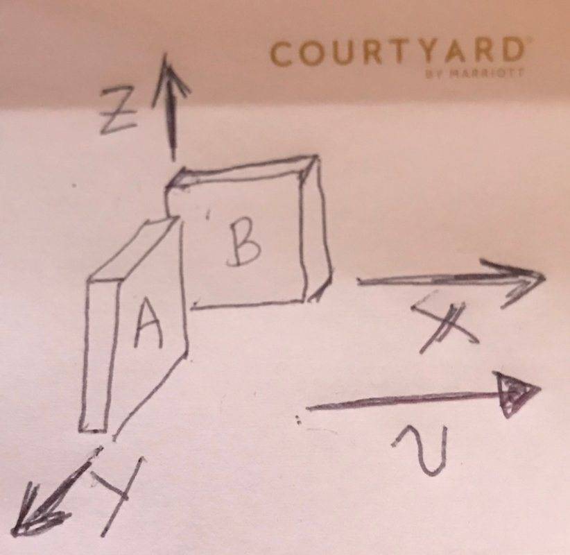

Two identical bodies are cooling at the same rate in frame S while an observer in frame S' has some explaining to do.......
Hi all,
Consider the situation depicted in the illustration. Two identical 'square plates' are situated at rest, in frame S, as shown: Plate A has its thickness 'a' parallel to the x-axis and its sides 'L' parallel to the y and z axes, while plate B has its thickness parallel to the y-axis and its sides parallel to the x and z axes. They are heated to the same temperature and then are accelerated until they attain a velocity 'v' along the x-axis with respect to an observer in frame S'. Now, in S', plate A will only have its thickness 'a' contracted while plate B will only have the side 'L' parallel to the x-axis contracted. This means that, for the observer in S', plates A and B have different total surface areas and, if we presume that a<<L and that v is in the relativistic range, this difference in total surface area will be dramatic. For the observer at rest with plates A and B, in frame S, the two plates will display the same temperature for all times as they cool (assuming, in this thought experiment, that we are in the vacuum of outer space and that outer space is homogeneous and isotropic). The identically dropping temperature readings, at all times, are an objective fact...how does the observer in S' explain this fact despite his perception of drastically different surface areas associated with plates A and B ??
Cheers...
Well, presumably, he's smart enough to know that he has to use length contraction to know what size the plates are in their own frame, which is all that matters to their temperature.

OK, I thought it was implied that the gauges can be independent of any SR effects: the two gauges are assumed to be situated on the y-axis and have the same x location, and thus they are not subject to the SR effects of the relative motion between frames S and S’, which is along the x-axis only.
Relativistic thermodynamics is not introductory, the purpose of this thought experiment is to see if people can spot fallacies easily or whether the scenario is worthy of more detailed mathematical analysis.
In that case, yes, the readings between the two devices will be the same in all frames of reference with zero relative velocity in the ##y## and ##z## directions. But even then, so what? All that tells you is that the edge of plate B that touches plate A has the same temperature as A, but that says nothing of the rest of plate B.

OK, in light of the good comments so far, here is how I will try to make clear the 'peculiarity' of the scenario:
(a) {I claim} The observer in the rest frame, S, of the two identical plates, A & B, will find identical time-dependent (due to cooling) temperature readings for all times.
(b) {For dramatic effect} We presume that the thickness, a, is much smaller than the length, L. This means that we are essentially dealing with 'square sheets' of side L.
(c) Because of the conditions specified in (b), as v-->c, we have that: The total effective surface area of plate A (whose thickness,a, is parallel to v) will approach (LxL)+(LxL)--essentially what it is at rest; the total effective surface area of plate B (whose side, L, is parallel to v) will approach an infinitesimal value (!)
Thus, here is the 'paradox':
For the observer in S there is nothing unusual going on--two identical 'sheets' are cooling down at the same rate...sure, no problem; for the observer in S' we are stuck with the situation wherein the essentially infinitesimal surface area (when v-->c) of plate B will be exhibiting some extremely dramatic physical processes such that it manages to radiate energy at the same rate as plate A, whose effective surface area has barely changed from what it is in the rest frame.
The two plates are identical in a 'very real' sense (identical material and geometry)...how can they behave so differently just because of relative motion? Could it be that SR is simply not applicable to such a scenario?

Sort of, yes. For definiteness, we will imagine that we've covered the surface of both objects with infinitesimally small mercury thermometers. Now we can make statements of the form "This particular thermometer on the surface of the object had this value as it passed thought this particular point in spacetime" and that is a Lorentz scalar. The values of the other thermometers or even of this thermometer at any other time and place are different Lorentz scalars.
Note also that every thermometer reads any given vaue only once and at most one thermometer passes through any given point in spacetime, so we can label the points in spacetime (which are conventionally called "events") by a thermometer reading: "This thermometer reads ##T##" identifies a particular event.
And with those preliminaries out of the way:
...so the effects you illustrate must in fact be 'superficial' to what is being discussed.
That does not follow.
Back in the first post of this thread, we specified that the objects "are heated to the same temperature", which is to say that we heated them in such a way that all the thermometers read the same temperature (which we'll call ##T_0##) at the same time, or equivalently for all the thermometers the events "thermometer reads ##T_0##" are simultaneous.
This is where the relativity of simultaneity comes in. In general, if two events are simultaneous in one frame they wil not be simultaneous in any other frame (this is why the words "at the same time" in any relativity thought experiment should set off alarm bells). Thus, our initial specification that the objects are heated to the same temperature is frame-dependent - if they are the same temperature in one frame, they will not be at the same temperature in any other frame.
Thus, the premise in your original post is mistaken. There's no need to explain the "The identically dropping temperature readings, at all times" using frame S' because they aren't identically dropping in that frame; both the initial and the ongoing temperature distribution is non-uniform. Of course that raises the question of how an observer at rest in frame S' does explain the thermal behavior of the two objects, and there are two ways of attacking that problem:
(We'll assume that all cooling is due to the emission of thermal radiation)
1) The easy way: working in the frame in which the plates are at rest and the temperature distribution is uniform so all the thermometers read the same thing at the same time and no relativity is involved, calculate the drop in temperature over time. Then Lorentz transform the coordinates of each "thermometer reads T" event into the coordinates of the primed frame.
2) The hard way: Working in the frame in which the plates are moving and the initial temperature distribution is non-uniform calculate the drop in temperature at each point over time. Be careful to include the effects of relativistic aberration of the thermal radiation emitted from each point, relativistic beaming, and maybe some other effects that I'm forgetting because only a total masochist woud ever want to attack the problem this way.
