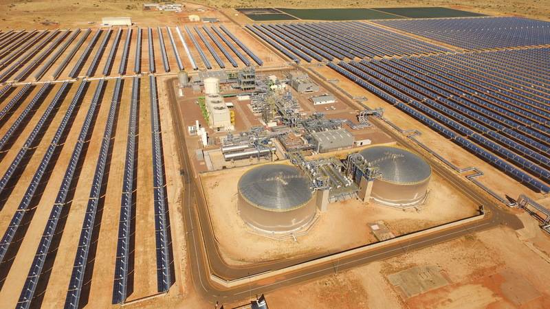

I thought any type of thermal power sation required a powerful cooling system and therefore had to be located near a large water mass (river, sea) or have big cooling towers: I have seen this in nuclear, gas or biomass stations. However, I haven't seen it in concentrated solar power stations despite they use steam turbines like any other termal station (if I am not mistaken). Once the heat is produced by any means, I suppose the thermodynamics should not be very different: why (thermal) solar stations do not need such big cooling towers nor large water supply like the other stations?

You are right, they do need cooling the same way as any other thermal power station.
As far as I know there are multiple reasons.
- since there is usually no water nearby at all, they prefer dry towers with forced ventilation. And those are lot smaller.
- usually these CSP stations are at lower capacity than those big power plants => less cooling is needed.
- the sheer size of the plant is lot bigger, and cooling is just harder to notice.
- also, those iconic natural draft towers are associated with 'bad power', so if it's just matter of choice then it'll be something else.
'Bookport CSP plant' is 50MW and all the cooling it needs is that three shaft white-ish block with the green piping on the right side of the block of machinery. The perspective is tricky that thing is still big from up close.
You can find some more here, for example.
