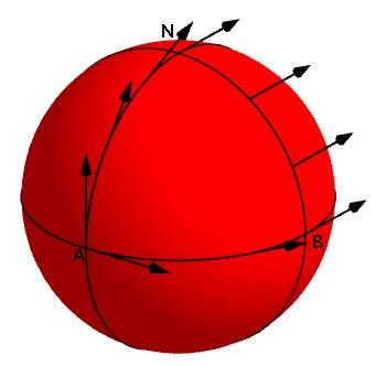

Unfortunately, you have gotten the concepts backwards. As long as the space is Euclidean there is a prescription to move vectors around and a unique definition of parallelism (it is just that it is not just using the same components in coordinates in the Cartesian setting - the components would change). If the space is not flat, then parallelism is not well defined and the parallel transport of a vector from one point to the other will depend on the path. I am sure you have seen the example of the parallel transport of a vector along the sphere.
It should also be noted that it is not necessary for a space to be Euclidean for there to exist a global notion of parallelism. However, the space does need to be flat. A non-trivial example would be the flat torus.

OK, I see your point.
However, my understanding of remote parallelism (and I admit I could have this wrong, too), is that if I have a polar coordinate system and move the vector to a new point, then the components of the vector will change (because the radial and theta directions are different at different points). But if it is Cartesian, the components will not change.
Could you please extend your post to this case?

I guess it depends on EXACTLY what "remote parallelism" means (for I have only found conflated definitions).
Does it mean that you can move vectors around (in that case yes, I had it backwards)
Or
Does it mean that if you move the frame around, then the vector's components do not change.
