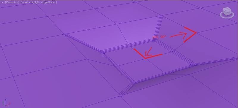

I tried to apply these ideas of ortoghonal vectors in a 3d software program (3ds max). I noticed that in all ways I curved the surface, the grid lines, which I think, can represent the coordinate lines, remained at 90° from each other. See below an Image of what I did.
So if the basis vectors are tangent to the coordinate lines at each point, they would be orthogonal to each other, despite the curvature of the manifold itself. What makes they not to be orthogonal in general? It's because they live in a four-dimensional manifold?
Note that that is a collection of flat spaces with discontinuities in the differentials at the joints. So any problems will occur at corners.
Take a look at the top corner of the depression where it meets the flat plane. Measure the angle between the basis vectors at that corner. The three quadrants outside the depression are 90°, but the corner that soans the depression is not. Remember that you need to measure in the surface - so the angle in that quadrant is the sum of the angles in the corners of the sloped polygons - which are not 45°.
Another thing to note is that the distance from one corner to the next is not the same as the distance across the middle of the depression. This is due to the extra distance from going up and down the sloped polygons. An obvious coordinate basis for this is to pick vectors in what the software calls the x and y directions (you can state that more formally if you like). Everywhere except the sloped polygons this corresponds exactly to the "vielbein" basis. But in the sloped polygons, one unit of distance in the x-direction is more than one unit in the plane. That means that the coordinate basis is orthogonal but not orthonormal there.
Note also that you've embedded your manifold in a higher dimensional space, which isn't a concept that is available in GR. So beware of relying on it...

Thanks Ibix for clarifying these things to me.
The corner is not at 90° because I used the smooth option to make it more beautiful. :smile:
